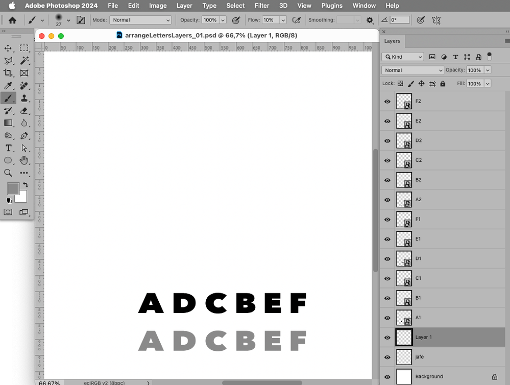

Jan 03, 2024 Jan 03, 2024
I have no access to the files on the onedrive server so I cannot test with them.
With a simple test file (with layers only for »a« through »f«) I was able to use the Script below to get an Array of Arrays (containing the Layer’s name, the index [which can be used to address/select the layer], the bounds [which can be used to calculate the necessary offsets]) in which the layers starting with the intended letter are being »rotated« (see the multiple »e«s for example).
// 2023, use it at your own risk;
if (app.documents.length > 0) {
var myDocument = activeDocument;
var originalRulerUnits = app.preferences.rulerUnits;
app.preferences.rulerUnits = Units.PIXELS;
var theString = "badebefefe";
var theLayers = collectLayersBounds ();
theLayers.sort();
var theRegExp = /^\D\d$/i;
// create arrays sorted by initial letter;
var theArrays = new Array;
for (var m = 0; m < theLayers.length; m++) {
    var thisOne = theLayers[m];
    var theCheck = false;
    if (thisOne[0].match(theRegExp) != null) {
        var theLetter = String(thisOne[0].match(/^\D/i));
        for (var n = 0; n < theArrays.length; n++) {
            if (theArrays[n][0][0][0] == theLetter) {
                theArrays[n].push(thisOne);
                var theCheck = true
        if (theCheck != true) {theArrays.push([thisOne])};
// check string against array;
var theResult = new Array;
for (var o = 0; o < theString.length; o++) {
    var thisOne = theString[o];
    for (var p = 0; p < theArrays.length; p++) {
        if (theArrays[p][0][0][0].match(new RegExp (thisOne, "i")) != null) {
            theResult.push (theArrays[p][0])
            theArrays[p].push(theArrays[p].splice(0,1));
alert (theResult.join("\n"));
app.preferences.rulerUnits = originalRulerUnits;
////// collect layers //////
function collectLayersBounds () {
// get number of layers;
var ref = new ActionReference();
ref.putEnumerated( charIDToTypeID("Dcmn"), charIDToTypeID("Ordn"), charIDToTypeID("Trgt") );
var applicationDesc = executeActionGet(ref);
var theNumber = applicationDesc.getInteger(stringIDToTypeID("numberOfLayers"));
// process the layers;
var theLayers = new Array;
for (var m = 0; m <= theNumber; m++) {
try {
ref.putIndex( charIDToTypeID( "Lyr " ), m);
var layerDesc = executeActionGet(ref);
var layerSet = typeIDToStringID(layerDesc.getEnumerationValue(stringIDToTypeID("layerSection")));
var isBackground = layerDesc.getBoolean(stringIDToTypeID("background"));
// if group collect values;
if (layerSet != "layerSectionEnd" && layerSet != "layerSectionStart" && isBackground != true) {
var theName = layerDesc.getString(stringIDToTypeID('name'));
var theID = layerDesc.getInteger(stringIDToTypeID('layerID'));
var theBounds = layerDesc.getObjectValue(stringIDToTypeID("bounds"));
var theseBounds = [theBounds.getUnitDoubleValue(stringIDToTypeID("left")), theBounds.getUnitDoubleValue(stringIDToTypeID("top")), theBounds.getUnitDoubleValue(stringIDToTypeID("right")), theBounds.getUnitDoubleValue(stringIDToTypeID("bottom"))];
theLayers.push([theName, theID, theseBounds])
catch (e) {};
return theLayers

Instead of moving the Layers wouldn’t it be easier to use Reveal All and Trim (respectively the corresponding AM-code)?

You are using DOM code; AM code usually runs »somewhat« to »a lot« faster.
Another recommendation: Hiding the Panels at the beginning of a Script and revealing them again at the end.
Might not seem like much of an influence, but the previews being generated for the Channels and Layers Panel for example seem to take some time.
app.togglePalettes();

How did you get the AM code? Did you record it yourself?
Could you please post screenshots with the pertinent Panels (Toolbar, Layers, Options Bar, …) visible?
