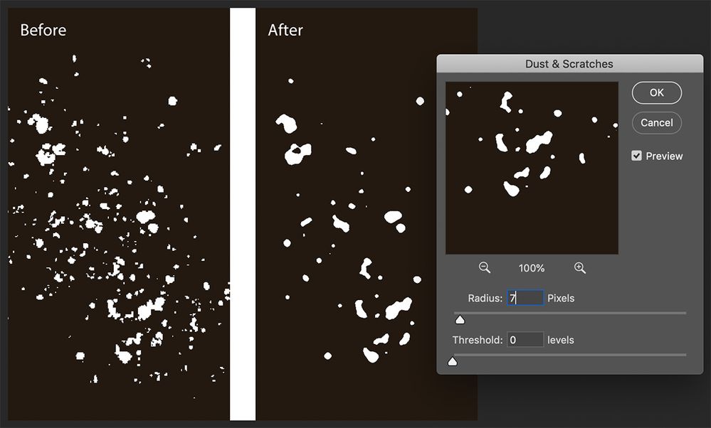

Filter > Noise > Dust & Scratches
Set the Radius to whatever value you like.
Votes

What are you looking to do?
Is selecting the smaller dots just a means to an end to remove them? If so, Michael Bullo's reply will do that, however, it will also affect the larger dots to some extent.
If you just wish to make a selection without affecting the larger dots, this is possible with some filtering and blending to manually create a pixel size threshold.

Aug 09, 2020 Aug 09, 2020
Copy link to clipboard
Copied
I tried with dust filter earlier but i am not sure that is 100% percent precise, and yes, I dont want to affect on larger dots than 2px radius, is it possible?
