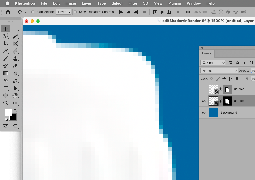

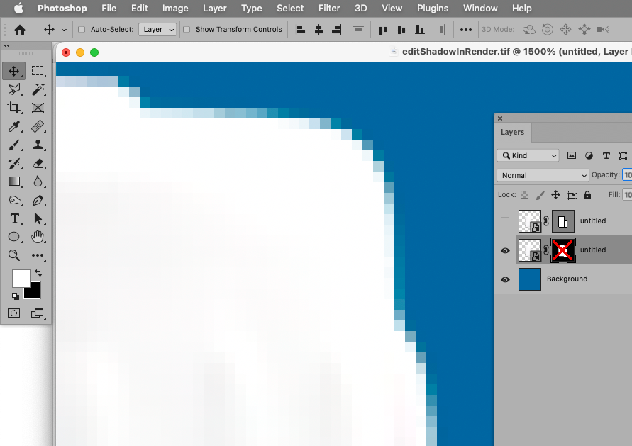

It will probably not matter in a case like this but keep in mind that using a Layer’s transparency on itself will also affect anti-aliased edges – check out the sharp edges of the bottle at a very high magnification with and without Layer Mask.
