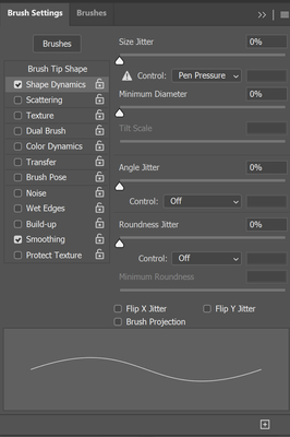

Not sure why but when I select Pen Pressure in Shape Dynamics/Brush Panel i Used to get a really useful tapered effect on my brush - perfect for my illustration style. Now that doesn't happen anymore and none of my presets from previous versions work that way either. I assume it must be an upgrade issue. I am using an Intuous 3 with Windows 8 (yes that was a struggle turning all the weirdness down) and the latest and greatest version of PS CC 2014 - Full Version. I'm sure there is a button somewhere that will fix this but I cannot find it and deadlines are getting closer!
I get a ! warning next to Pen Pressure when selected, and that can't be good.

Hello - well desperate times! I seem to have fixed the problem. Windows comes with a bunch of options to "plug and play" various tablet devices - it seems that although the Wacom driver is installed and working you still need to jiggle around with some of the other controls before you get what you need performance wise. Anyway, I went into my Contol Panel and opened Devices and entered the Wacom Properties via there and added Photoshop to the list of programs the tablet is used for. This has worked - I no longer have the warning and my taper is back. Happy now - busy drawing! I hope if anyone else has this problem this solution helps.

Thanks Benjamin, it appears I was a bit premature with the solution. It seems that there are many variable now. Whenever I go to use a modifier key from the keyboard it seems to lose the connectivity with my tablet and the problem reoccurs.
Still looking for a concrete set of procedures that fix the problem and stop it from reoccurring!

Okay - right now I have it working. I have uninstalled and re-installed drivers - messed around with all the Windows settings and turned a variety of settings on and off.
This worked: Removing the preference file from Wacom Tablet Preference File Utility and then adding Photoshop to the Application area. (Intuos 3 and Windows 8, PS CC 2014)
So the brush worked for a few moments but then I tried unchecking Use Ink in the mapping area and I lost sensitivity again.
So now I will see if there is a set of things that will consistently work to reinstate the pressure sensitivity.
I also found another thread on these forums discussing this same problem. I also have the problem with my cintiqu and Windoes vista with Photoshop CS6.New Wacom driver installed.

Okay - it seems that I need to delete Wacom Prefernces quite a bit - reinstate my changes and keeping the Wacom properties window seems to help too

So, it turns out to be NOT a tablet problem at all.
There are TWO brush menus in Photoshop. If you just use the one and select "Shape Dynamics", you have only done half the jobe. You ALSO have to go to BRUSH PRESETS and select a brush that tapers.
This works EVERY time.

No it doesn't. I have the same issue while using my Wacom Intuos and the brush presets do not taper, even the ones that are supposed to. You can see in the stroke preview that it no longer tapers. I also have the exclamation mark beside the Shape Dynamics control.

I'm also having this issue using a Huion Kamvas 22 Plus. It's worked fine with Photoshop in the past but I just recently ran into this issue and I can't figure out what's causing it. Works fine in Clip Studio and other applications so it's definitely an Adobe glitch.
So far I've tried re-installing Photoshop and the Huion driver, used 3 different versions of Photoshop (2022, 2023 and 2024), and even tried the "PSUserConfig" fix but I'm still not getting any change in pressure.
