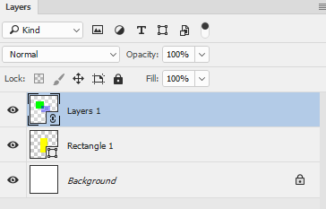

Hi
It looks to be working here.
Image 1 conists of 3 layers with opacity as shown in the layer panel
When linked as a smart object in image 2 - the layer opacities are retained
If that does not work for you , I would try resetting preferences
Dave
