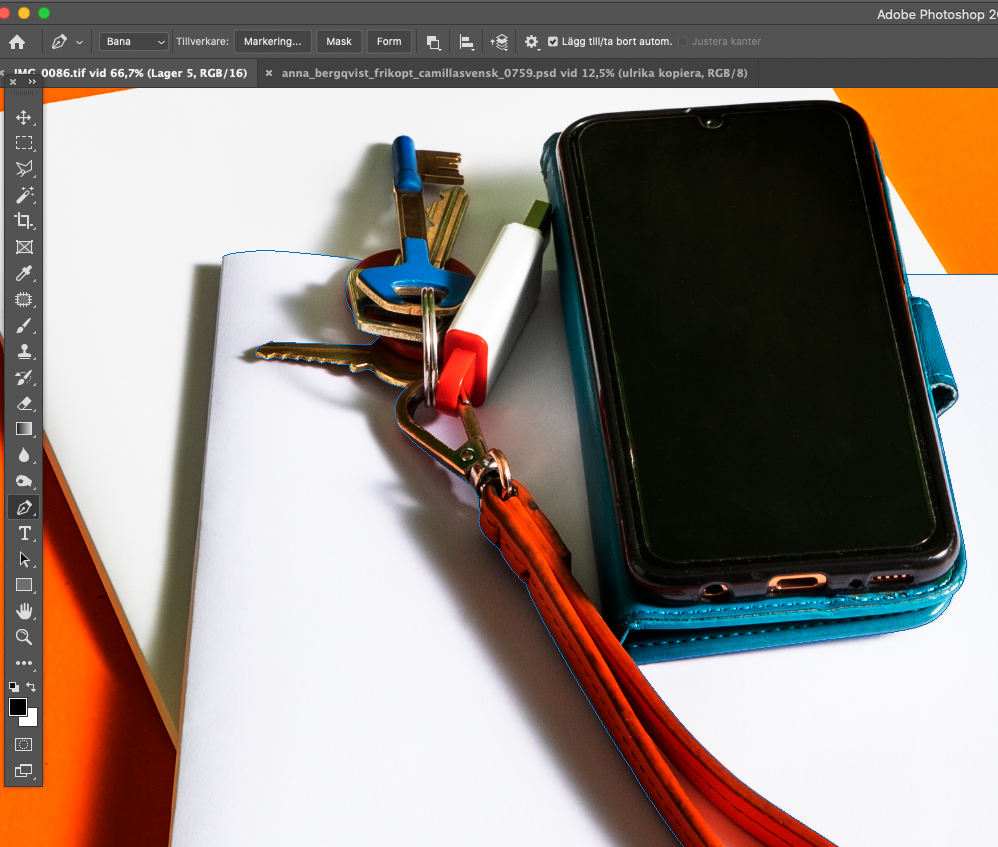

I have version 21.1.1 of photoshop and this is a photo of my path. Screenshot 2020-03-31 at 19.18.03.png

Mar 31, 2020 Mar 31, 2020
What are the other pen tool options you show selected? Is the box next to "Auto Add/Delete" checked? Can you post a screenshot of your tool bar with the pen tool selected?

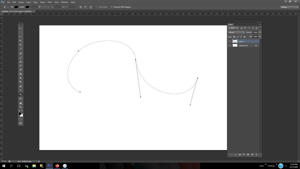

OK thank you. I can't see it that well, but here is what the toolbar should look like to be able to add anchor points. Sometimes you can inadvertently uncheck or check the wrong thing (never mind how I know this haha): -edit- these are in CS6. Maybe something has changed?

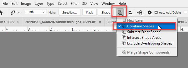

For your question on paths being reversed - go to the options bar and set "Combine shapes"
