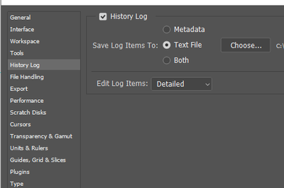

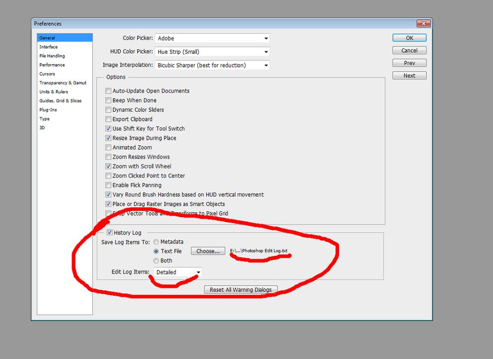

@J.C.C.1, аs @r-bin noted, Photoshop has a built-in logging function. At a concise level, there is enough information to understand which file and at what time work is being done. Perhaps you should just enable this option and write a log file parser that will collect data into a single table

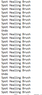

I could be doing something wrong, but with the photoshop history log to a .txt file all I get is the steps. No time stamps, or potential idle time between log entries.
