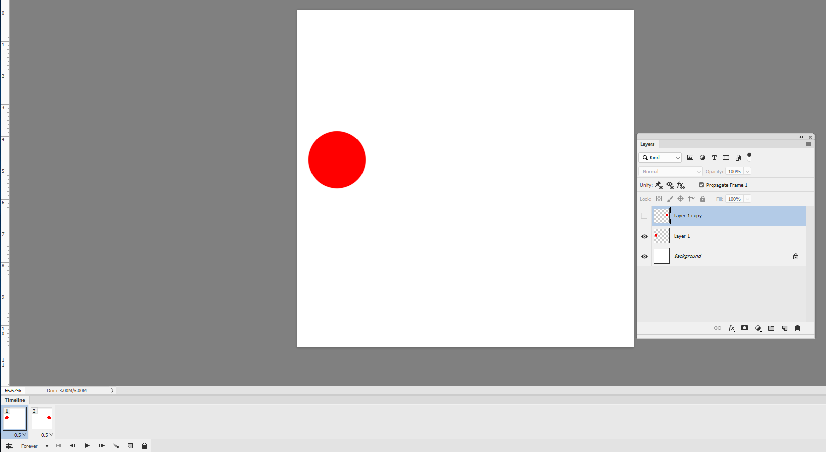

Hi
If your frames are based on different layers then the "tween" menu item works by inserting frames and creating a "dissolve betwen them i.e. fading out the first frame and fading in the second second.
Before tween :
After tween - see the fade between the layers in the timeline:

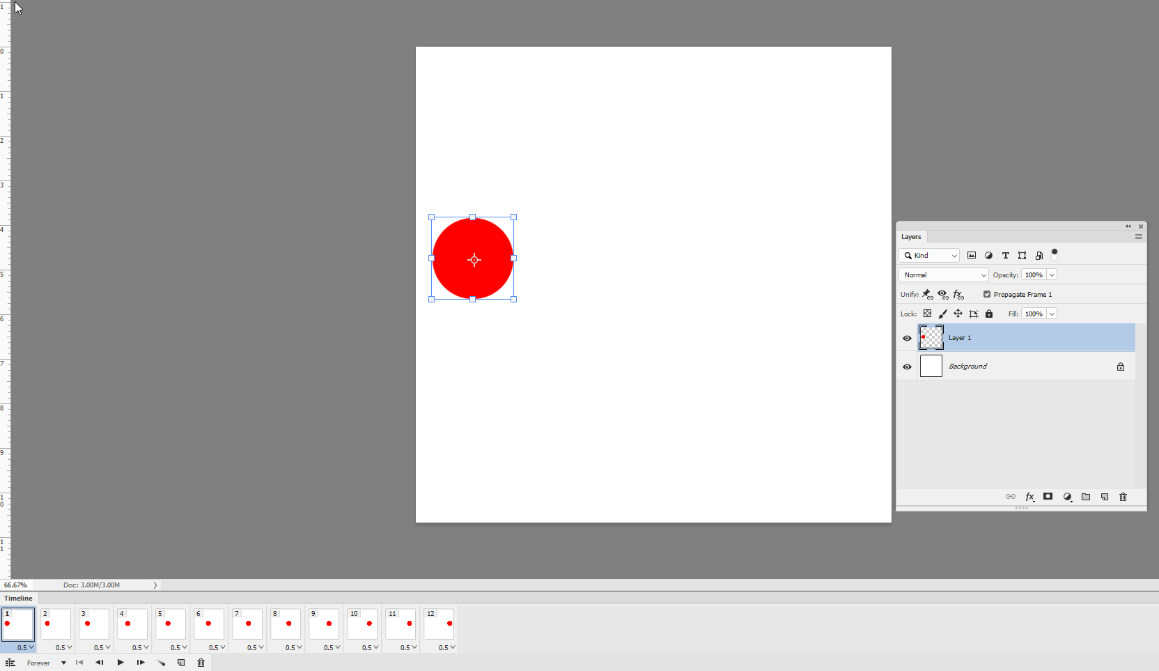

However, if your frames are based on the same layer but with the position of the layer moved - then the tween will generate "in between" positions on each frame:
Before tween
After Tween (note the frames showing the moving position of the layer in the timeline
I hope that helps
Dave
Contributor ,
Feb 22, 2019 Feb 22, 2019
Ah so not possible to "morph" the images from one frame to another? They are different images that are similar.
Movement between frames that use the same layers in different positions can be done with tweening. But, if the frames use different layers, then you are limited to a dissolve effect not a morph.
Dave
