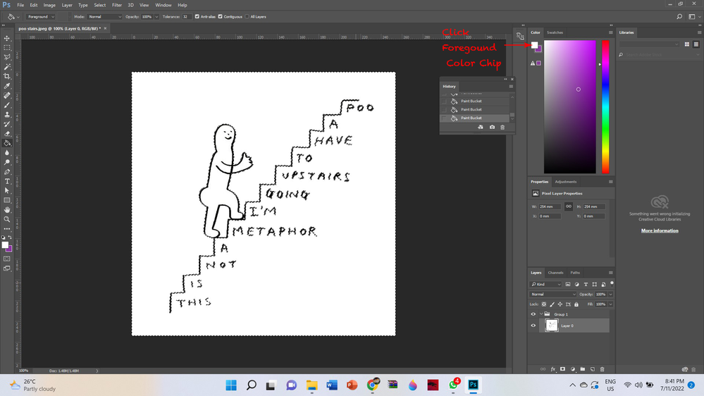

Hi, I've been trying to change the white background of a picture to another colour using the magic wand tool and paint bucket tool but it doesn't change. It stays white even after clicking multiple times. My steps:
1. Select the white background with magic wand
2. Select the colour at the right side
3. Select the paint bucket tool
4. Select the white background with the paint bucket tool
Below is a picture of the issue.
I've actually used this method before to change background colours but today, it just is no longer working and I'm not sure why. Thank you for any help!

Community Expert , Nov 07, 2022 Nov 07, 2022
In your screenshot your Foreground Color in the Tools Panel is set to White.
It looks like the Color Panel is set to add color to the Background Color instead of the Foreground and that's why your Paint Bucket Tool is not working.
To reset the Color panel click on the Foreground Color Chip, then when you select colors it should work with the Paint Bucket Tool
Community Beginner ,
Nov 09, 2022 Nov 09, 2022
thank you, it worked!!
