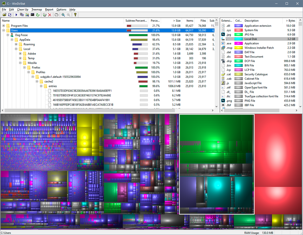

Even a 250GB system drive should be usable as pimary scratch disk, and even go a pretty long way, if you clean it out thoroughly and move everything possible over to external storage. That's always better than scratch on external drives.
Just remember to never save directly to an external drive. Save locally, then move. Having to rely on external drives is cumbersome in any case, but a few precautions make it at least workable and safe.
A standard configuration of operating system and a range of applications will take up around 80-120 GB. The rest can be used for primary scratch.
The user account accumulates a lot of unnecessary items. Start with Disk Cleanup in the operating system. This can be surprisingly effective. Next, for Windows there is a free utility called WinDirStat, which shows exactly what's filling up the drive and where it is. A lot of it can be deleted without harm. The outlined area here is the user account. Also, hibernation can be disabled, and then the big red blob here disappears:

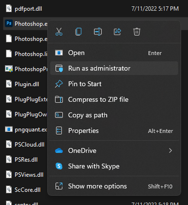

Quick format should be fine. If you navigate to your Photoshop.exe file (most likely found in this path - C:\Program Files\Adobe\Adobe Photoshop 2022) right click that file and select "run as administrator".
When running the app as an admin, does that allow you to see the drive?
Referencing this thread here: Solved: Photoshop 2022 Scratch Disk not showing all hard d... - Adobe Support Community - 12529145

That reminds me, I have to run photoshop as administrator everytime or it freezes or doesn't let me select menus, it's very glitch, not as solid as the old programs before 2010, no the quick format or the run as administrator don't work to have the drive recognized,  I just buy a ssd drive for $49.99
