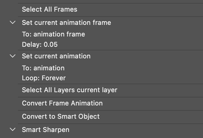

m73531472
m73531472Author
April 16, 2025
@Claire H.hi Claire, thanks for your help. I've updated my computer and photoshop and tried with step 2. I realized while doing some testing that I convert the frame animation to 0.05 seconds before converting to a video timeline. This seems to be the crux of the issue. When I don't, the export works fine, in that the frames prior to turning into a video timeline were 0.03, converted, then exported still remain at 0.03.
I'm attaching my workflow below
I guess I would expect that the 30fps is honored from the video timeline but that's not what eventually ends up exporting. If I don't touch frame delay before converting to video timeline, it seems to work as expected. Otherwise, with 0.05 -> convert to video timeline -> export then reopen, then I seem to get the 0.03 and 0.07 oscillating frame rates.
