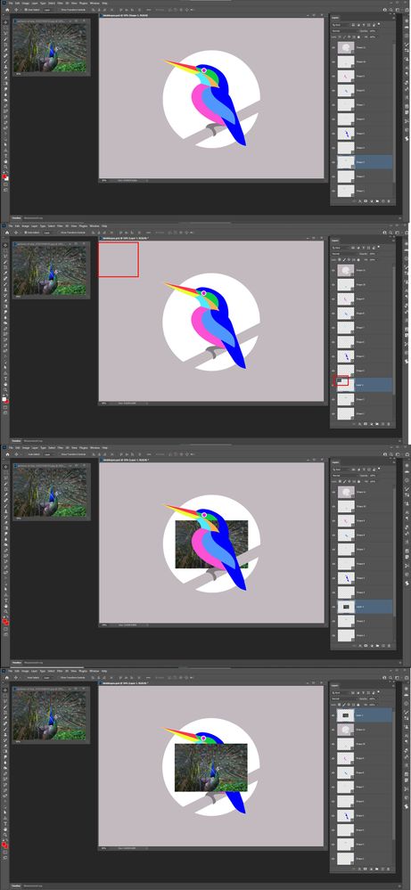

One windows 10 PS 22.4.2 this is what I see.

Bojan Živković11378569
