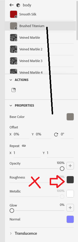

you have a few questions there so I'll try to answer them but I may need to see your Dn file so these are best guess on my part;
q1 can you export models = yes... assuming you have the current build of Dimension Obj is always your best option and avoid exporting as Dn if you need to update computers or move between systems
q2 can you adjust materials = yes and no... there are two different types, normal i.e, Nvidia standard allows you to adjust everything but if you use a map {black and white mask image} then that overrides the sliders.
the second type is Substance materials and you need the Substance software to make | adjust these... they do have some adjustments but its up to who ever made them as to what those adjustments are
q3 sounds like you made a woppie like the first image below with lots of default materials you don't want?
the fix [see 2nd image] is to use the eyedrop sample tool
1 select one of the default materials you want to remove
2 use the eyedrop tool to click on a part of the model (in this example titanium is my base material)... the default material now is removed and replaced with what ever you clicked on

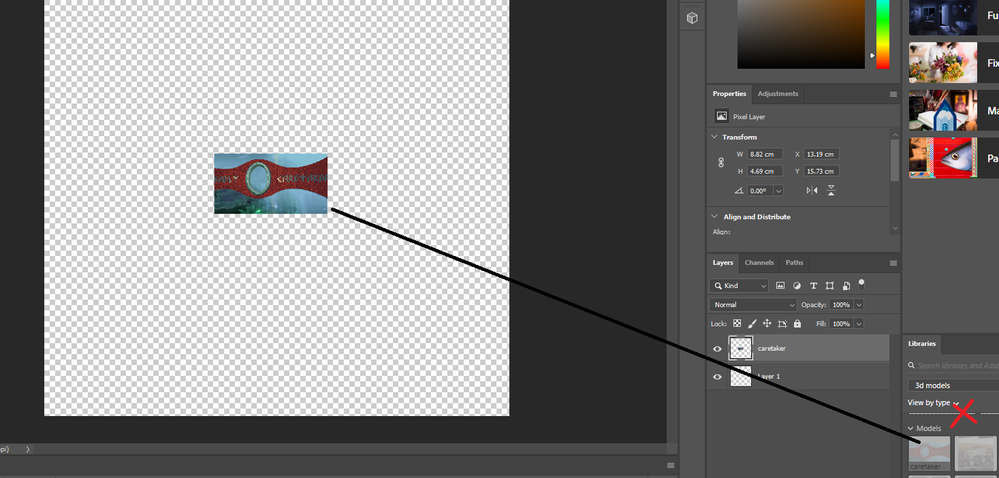

q4 save to cc library is new and riddled with bugs so be careful
image 1 = how to get the model into your library... note that you should only select the model itself... the image you see in the library panel is a snapshot
what you get back out in Dimension is the model only however if you try to open the file in Photoshop its the snapshot that gets sent
