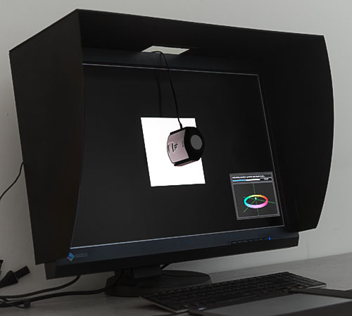

D Fosse
January 20, 2019
OK, I just have to reply to that
That just means you have a TN-type display, generally considered unsuitable for photographic work for precisely this reason. High-quality IPS monitors don't change with viewing angle.
TN panels are used in office and gaming monitors - and most laptops - because they are inexpensive and accuracy isn't needed. IPS panels are rather more expensive.
As for reliable colors, you get that by using a calibrator that measures the display and creates a monitor profile. Then you need to use color managed software that will actually use the profile. Phones don't support color management at all and don't qualify here.

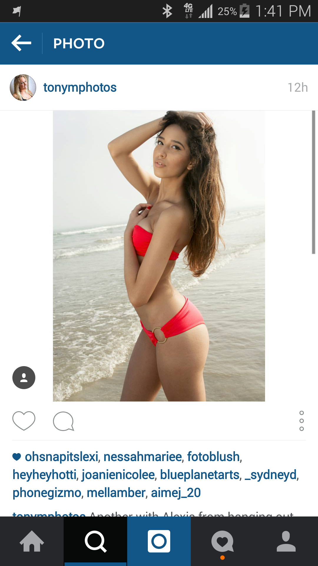

August 23, 2015
Yeah, it's pretty off, as you may see from the exmples here. One is directly from my computer and the other is a screenshot from my phone...it's a relatively simple edit, but you can tell the drabby looking color in the screenshot, or at least, I hope you can.
Chuck Uebele
August 23, 2015
The image from your computer looks like it might be Adobe RGB and the phone sRGB - at least it has that look from your samples.
