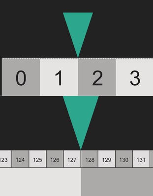

If it is 0 - 255 then there are 256 numbers, so the true middle of that amount is 128. Since each value is different, starting at 0 or 1 does not make a difference. Taking the 0 - 255, it could be reimagined as 1 - 256 which may help to understand where I am going with this.
New Here ,
Sep 09, 2023 Sep 09, 2023
What you're describing would be "half" with respect to cardinality (i.e counting individual distinct items). But in this context, we're not so much counting as we are -measuring- along a continuous range (and then quantizing that range into a series of discrete portions). For a continuous range of memory divided into 256 sections numbered 0-255, the midpoint of the range is exactly where the end of the 127th section meets the start of the 128th section. It makes more sense to say that is exactly halfway between section 127 and 128, as opposed to saying its just 127, or just 128.
Sep 10, 2023 Sep 10, 2023
But you can't have 'half way between 127 and 128' represented in 8 bit integer. It has to be 127 or 128 and conventional rounding has been applied to use 128.
Dave
New Here ,
Yes, I wasn't trying to suggest otherwise, Dave. I was only atttempting to illustrate to user Ethan31571945r33i  why 127.5 was previously called the true midpoint of the range being discussed.
