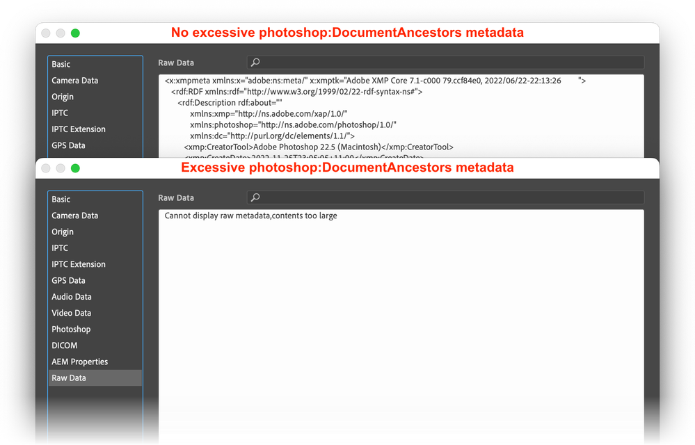

@Alex782012 – I asked for the Raw Data tab, not the other tabs such as Basic. Illustrated below:
Excess photoshop:DocumentAncestors metadata can add up, however, this may be only part of the answer even if it is present.
