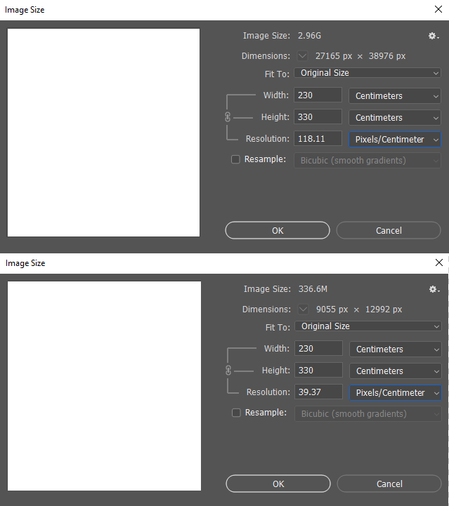

The difference between 300PPI and 100PPI or 118.11PPCM and 39.37PPCM
‭1,058,783,040px vs ‭117,642,560px‬ is 9x Image size an 8 bit pixel is 3Bytes and 16bit pixels is 6Bytes.  You do not need a high resolution image for a rug.
