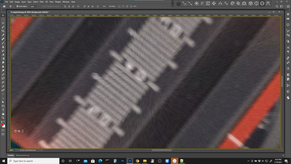

Use what you prefer. If you take a  zenith and a nadir image you may be able to stitch them in with the other images you have taken to be stitched with PTGUI and be done with it.. How good of a stitcher is PTUGUI.  Panorama Tools were programmed many years ago.
If you edit a high resolution image at 100% zoom Actual Pixels the high resolution nadir will most likely not fit on your display.  Photoshop is editing your High resolution image  but  is displaying your nadir quickly scale to a smaller size.  Not scaled for the best image quality but for faster performance.
Yout nadir viewed 100 % one my screen
JJMack
Votes

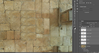

Explorer ,
Jan 20, 2021 Jan 20, 2021
Copy link to clipboard
Copied
I agree when you say that PS is displaying nadir with lower quality in order to improve performance.
The whole 3D layer is displayed with lower quality and when you export the panorama, it is exported  with original quality, so that if you display the equirectangular panorama in a viewer, the quality is as original.
I also think that when i edit the 3D layer in PS (creating an empty layer, and merged afterward with the 3D layer), the quality of the edited layer is the same than the quality of the displayed 3D layer.
When I export this edited panorama and display the 3D view in a viewer, the unmodified part are with the original quality and the edited parts are showing lower quality.
It seems that you do not have the same behavior and I don't understand why.
This is hardly not visible on grass floor but more evident on pavements.
Original image in PS
tripod removal in PS
Result in 3D Viewer
Votes

Copied
Even when you zoom 100% actual pixels the patch will be softer the none patch area.  Photoshop can only do so much, The replacement pixels are from areas near the patch areas.  The actual 2D 360 Spherical Panorama Project is extremely distorted in the nadir and zenith area.  The image quality in there areas is not high resolution quality.  I'm quite impressed that Copy and paste and content aware fill do can do as well as they do working from the distorted spherical panorama projection image's nadir.
JJMack
