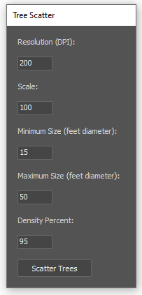

For plan renderings, I currently use tree/forest scatter brushes with layer styles applied, but this method doesn't look as great due to not having the shadow in the tree canopy. I thought about having a pattern overlay that incorporates trees canopy shadows, but then you have to get precise with tree brush placements on the edge of forests to match up with the texture and if needing to change the shadow direction, the pattern overlay would need to be rotated too and the forest border would need to be refined.
General Solution
Create a tool that can scatter trees on individual layers so bevel and emboss can be applied to each canopy vs an entire forest canopy mass. Downside is it's processing intensive and if there are significant design updates, the quickest thing would be to delete all trees and run the script again so the script needs to be efficient to run on your average laptop. There would be a "forest area" layer that is just a solid fill for where trees should be scattered/spawned so that border can be easily selected to run the script.
What I've done so far
Used AI to create scripts and experimented with different methods to try and get desired results with optimization. I first tried to randomly place trees as smart objects, but couldn't get the script to respect a pre-selected forest area very well and it was very slow. Then tried a grid sample approach if a point was in the selected area to spawn trees, this was slow and I let my pc process overnight, but never saw results. Lastly, switched to a stamp method (see attached image and script) which works alright but it didn't achieve the desired density and was relatively slow since it has to open and close a tree.png for every tree placement which could be hundreds of times, which is not ideal and some trees are too overlapped. I tried improving it to increase density, reduce overlap, and even open all the tree .pngs first and/or add them to the same .psd and reference them for better performance but couldn't get those options to really work.
Another solution would be to have an array of trees with realistic shadows vs dropshadows that are connected to a dynamic border, but I haven't seen anything like that in Photoshop to know if that's feasible.
Disclaimer: the trees and the effects below are just a quick draft to see if it's possible to work with a script (tree .png's are attached). If someone here can improve this script or Adobe creates a better workflow for this, then I'll create much better looking trees and effects.

    var dlg = new Window("dialog", "Tree Scatter");
    dlg.orientation = "column";
    dlg.alignChildren = "left";
    dlg.add("statictext", undefined, "Resolution (DPI):");
    var resolutionInput = dlg.add("edittext", undefined, "200");
    resolutionInput.characters = 5;
    dlg.add("statictext", undefined, "Scale:");
    var scaleInput = dlg.add("edittext", undefined, "100");
    scaleInput.characters = 5;
    dlg.add("statictext", undefined, "Minimum Size (feet diameter):");
    var minSizeInput = dlg.add("edittext", undefined, "15");
    minSizeInput.characters = 5;
    dlg.add("statictext", undefined, "Maximum Size (feet diameter):");
    var maxSizeInput = dlg.add("edittext", undefined, "50");
    maxSizeInput.characters = 5;
    dlg.add("statictext", undefined, "Density Percent:");
    var densityInput = dlg.add("edittext", undefined, "95");
    densityInput.characters = 5;
    var scatterButton = dlg.add("button", undefined, "Scatter Trees");
    scatterButton.onClick = function() {
        var resolution = parseFloat(resolutionInput.text);
        var scale = parseFloat(scaleInput.text);
        var minSizeFeet = parseFloat(minSizeInput.text);
        var maxSizeFeet = parseFloat(maxSizeInput.text);
        var treeDensity = parseFloat(densityInput.text);
        if (isNaN(resolution) || isNaN(scale) || isNaN(minSizeFeet) || isNaN(maxSizeFeet) || isNaN(treeDensity)) {
            alert("Please enter valid numerical values for all fields.");
            return;
        if (resolution <= 0 || scale <= 0 || minSizeFeet <= 0 || maxSizeFeet <= 0 || treeDensity <= 0 || treeDensity > 100) {
            alert("Resolution, scale, sizes, and density must be positive numbers; density must be 0-100.");
            return;
        if (minSizeFeet > maxSizeFeet) {
            alert("Minimum size cannot be greater than maximum size.");
            return;
        scatterPNGsInArea(pngPaths, scale, treeDensity, resolution, minSizeFeet, maxSizeFeet);
        dlg.close();
    dlg.show();
main();

• Full color brush tips would be a useful improvement and I think Feature Requests on this issue exist. (Though they may have been back on the now defunct feedback.photoshop.com.)
• One can »high-jack« Tools one uses little (in my case the Count Tool or the Color Sampler Tool) to have a Script insert duplicate Smart Object instances to manually set positions by using Script Events Manager.
• A while back I created a Script (and while I think I posted it on the Forum I cannot locate the thread at current) for distribution of Smart Objects in a Group according to a Channel.
