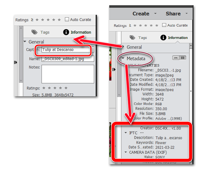

There are several ways to add a caption to an image in the Organizer.
  • If you double click an image so that it is full screen, you will see the following text:
When you click on it, a blank text box will open and you can add your caption text.  Once you hit Enter, the caption will appear below the image:
  • If the media grid is zoomed out, you can select an image, right-click on it and select Add caption.  Type your caption in the text box that opens and the caption will be added.  But you can only view the added caption under the image if it is in full screen view.
  • A third method is to add a caption in a text box that appears at the top of the Information panel at the right of the Organizer screen.   You will always see an added caption for a selected file in the grid in this text box.  The text box can also be used to add or edit text for a single selected file.  If you select more than one file, the text disappears.
If you are not talking about captions in the Organizer, but want to add text underneath a photo that will then be saved e.g. as a jpeg file, let us know and give us a better description of what you want to do in the Editor.
