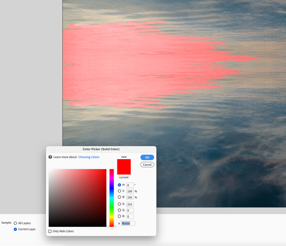

In Enhance>Change Object Color, how does one apply the selection to just the current layer? The option pops up in the lower left corner when one selects the Color Picker "Change Color to", but it cannot be modified.  Screenshot 2025-07-10 at 11.45.36 AM.png

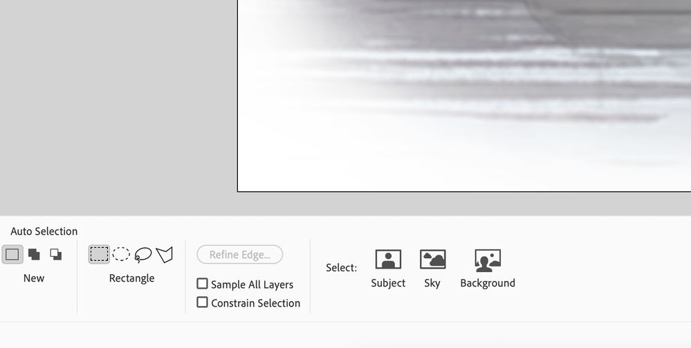

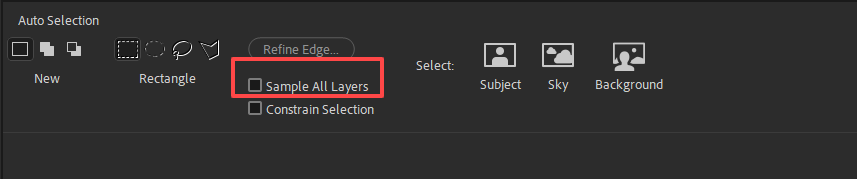

When you make the selection uncheck the option to Sample All Layers.
New Here ,
Jul 10, 2025 Jul 10, 2025
Yes, the Sample All Layers is unchecked before the selection, but then switches to checked after the selection.
Perhaps a bug?
Screenshot 2025-07-10 at 11.45.36 AM.pngScreenshot 2025-07-10 at 12.11.42 PM.png

I will investigate whether that is a bug when I have some more time later.  But as shown in your screenshot, there is an option in the Color Picker to Sample Current Layer.  Does that work for you?  If not, please post a screenshot of your Elements window with the layers panel displayed.

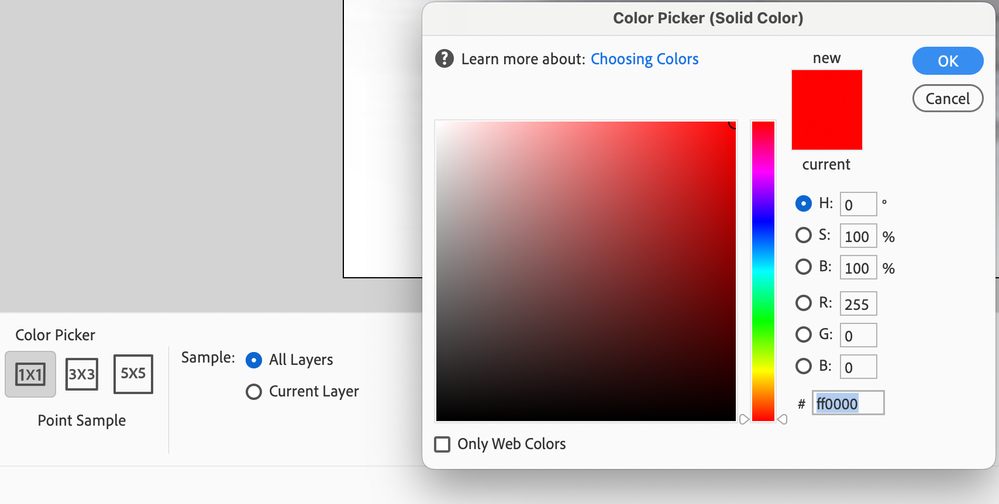

New Here ,
Jul 11, 2025 Jul 11, 2025
As I mentioned previously, once the Color Picker is selected, one cannot change the Sample to Current Layer.

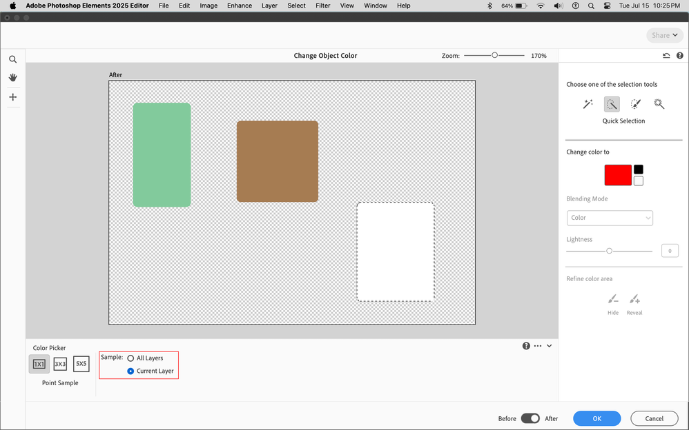

Jul 15, 2025 Jul 15, 2025
You can change the setting for the Eyedropper Tool before clicking on the Change color to chip by pressing I on your keyboard to bring up the Eyedropper Tool. The setting should stick after that.

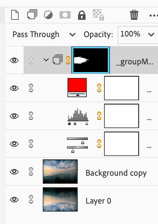

@Jeff Arola, as I understand it, the OP's issue is not so much with changing the color in the picker, but in changing the object color when the object is on a different layer than the top layer.
@Seaweed1, have I correctly expressed your issue?  Thank you for providing the screenshot.  Can you explain in more detail what you are trying to do with the Change Object Color tool.  As best I can tell, you have a seascape photo and have created a second layer trying to create a reflection - of what, I am not sure.
What object is it that you want to change the color of?
And are you intending to use a blend mode to affect the ultimate result?
Perhaps there is another way to get the result that you want to achieve.

@Jeff Arola, you are correct, that one can change the setting for the Eyedropper Tool before clicking on the Change color. However, that does not change the behavior of the Change color function; it still affects all layers.
@Greg_S. The seascape photo is simply an example; the actual file and image I'm working on are proprietary. To describe what I am trying to do is to change the hue and color of a selected part of an image layer.
I see that the Change Color function applies an Adjustment Layer, which affects all Layers.
Is there another (better) way to do this adjustment?

LEGEND ,
Jul 16, 2025 Jul 16, 2025
There is no need to use the adjust color interface.
Simply make a selection on your chosen layer and then click the layer mask button.
Add a new adjustment layer from the layer menu e.g hue saturation
Clip the adjustment layer to you chosen layer (Alt+Click)
Adjust the sliders to your taste.
