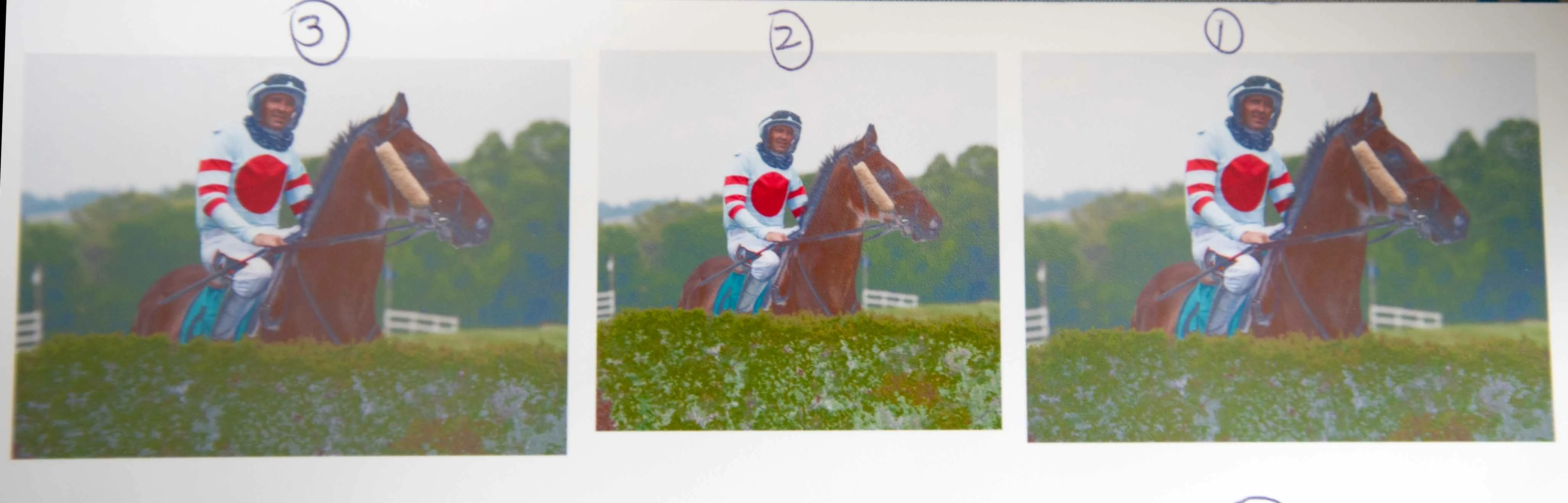

I just started experiencing first-time problem with my Epson R3000. In any mode -- printing via Photoshop, Photoshop Elements, or the printer's own software -- the prints look something like a negative, with cartoonish colors (see attached -- I used various settings and got these same results).  For the record, I have taken all the normal steps in an effort to fix the issue: delete the printer and add it again; uninstall the driver and reinstall the latest one (on both computers.) I checked all the settings - paper profiles, color management, etc.  I also checked the nozzle (they were fine) and did a head cleaning. Yet, the issue repeats itself is the exact same way over and over, no matter the settings.
The problem manifested itself the moment after a successful printing session when I needed to switch from color printing on Epson Ultra Premium Luster paper to B&W printing on Epson Velvet Fine Art paper. I adjusted the necessary software settings and also changed the settings on the printer itself -- to accommodate the Velvet paper and print it through the front manual feed. I also switched the ink setting from Photo Black to Matte Black. And that might be the genesis of the problem. All of the B&W prints were out of whack (see attached image which shows a garish bluish cast -- other versions showed a similar cast only greenish). The Matte Black ink was old. I rarely use it. Could my issues have something to do with old ink messing up the entire printer? Even though there doesn't appear to be a clog, could it be responsible for the problem? I can't seem to solve this, try as I might. Any assistance is deeply appreciated.

I will contact them tomorrow (Monday). Right now, I am (back) for the third straight day at the computer/printer, trying to trace my steps since things went sour. I tried printing out thumbnails of a differe nt photo, and noticed some light banding. So I am performing a series of nozzle checks/head cleanings. It is not clear that there was/is some clogging in the matte black compartment. Performing the fourth cleaning now, and the breaks in the nozzle check are slowly disappearing. The key question is this: Could  clog in the matte black nozzle (from using an old ink cart) cause an entire print to look so bizarre?
Eureka! The problem is corrected. It was, in fact, a clog in the matte black nozzle. It took seven head cleanings to correct. The clog wasn't initially evident from the nozzle check. I made additional test prints with an image that more readily revealed horizontal lines, indicating something was wrong with the nozzles. Lesson learned. Yes, using an old ink cart can, indeed, cause major printing issues. Thanks to all who chimed in!.
