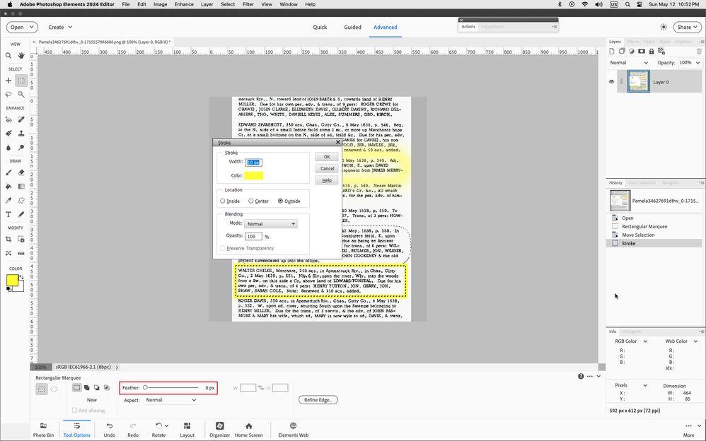

I had success (almost!) in outlining text by doing the following:
  1. Select a paragraph using the rectangular marquis tool
  2. Select Stoke/Outline from the Edit Drop-Down menu
  3. Set pixels at 20
  4. Select color (yellow)
  5. Set "outside" for location
  6. Blending mode "Normal"
  7. Opacity 100 per cent
  8. Everything works out okay EXCEPT that the border won't take the color.  It remains gray.  What am I doing wrong???
Jeff Arola
May 13, 2024
I tried changing the text page image from black and white to color.  I then repeated the process.  There is now a yellow "box" around the text that I wanted to highlight, but it looks more like a smear than a box.  I am enclosing a screenshot below.
Thank you for your help.
Pam
In the tool options for the Rectangular Marquee Tool make sure the Feather is set to 0 px (zero) before drawing out the selection.

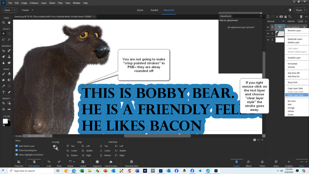

Place Text and click the green check to finish. Then right-click on text and choose Edit Layer Style from the pop-up menu. Then choose Stroke and pick your Size, Position, Opacity, and Color.

Is there anyway to make the border less rounded? I like how on Pixlr the border has sharp edges like the text. If not, this will definietly still get the job done.
Glenn 8675309
April 29, 2024
No.  Crisp sharp corners are not part / not an option of PSE.

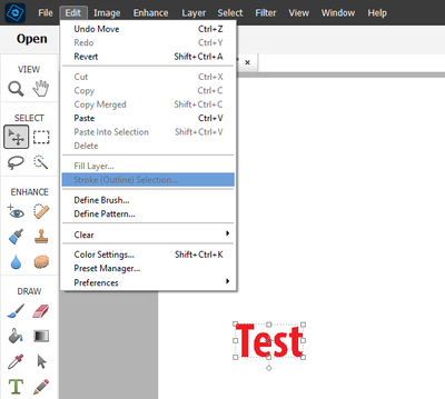

Try Edit > Stroke.
October 17, 2021
It won't let me select stroke.
Peru Bob
October 17, 2021
Highlight (select) the text first.
