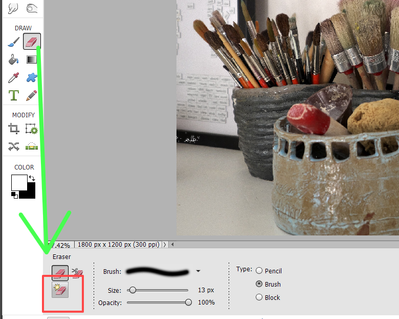

Where did you read that the Magic Eraser is no longer an option?  Jeff's suggestion that you be in Expert Mode will help you find the Magic Eraser tool since the default mode when opening the Editor is Quick Mode and the tool is not visible there.  If you have not found it yet, click on the Eraser Tool and the Magic Eraser Tool will be in the Tool Options panel at the bottom of the screen.

First you need to be in Expert Mode then you'll have access to the Eraser Tools.
