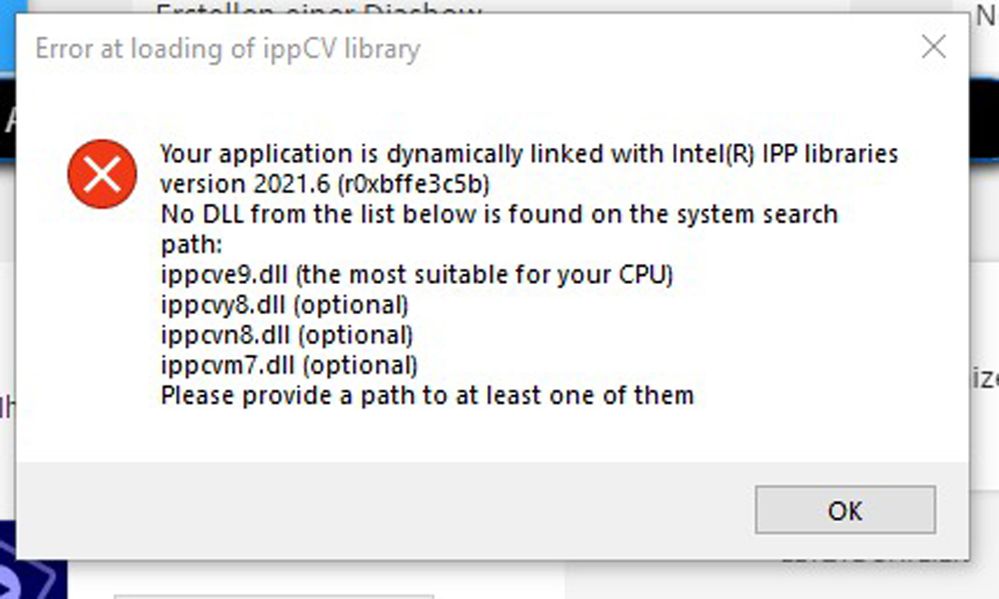

Hallo, hatte Photoshop Elements 2024 bereits erfolgreich installiert, aber nach einigen Tagen lief nichts mehr! Bekam dann folgende Fehlermeldung (siehe Anhang). Hat jemand auch Erfahrung damit?

@Lothar16B8 ,
Das hier scheint aber Windows zu sein? (welche Version bitte?)

Ja, denke ich auch. Installiert ist Windows 10 Home Version 22H2.

Both problems seem to be related to the recent update of Elements 2024.
@Lothar16B8, the workaround is to roll back the program to before the Elements 2024.2 update and turn off automatic updates.  See this post for a link to download the earlier version.
Adobe is aware of the Mac problem that seems to be affecting German, French and Japanese users, perhaps because the update added the Elements Web for those languages.  I am not aware of any solutions for the crash when accessing Preferences.  I suggest contacting Adobe Support and requesting a download link for the original Elements program.  Hopefully, it will still work for those who have updated to Sonoma 14.4.  I will ping @Jeff Arola, another Community Expert who is far more familiar with Macs than I am.  (I know almost nothing.)
