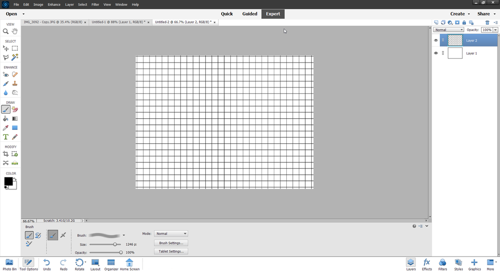

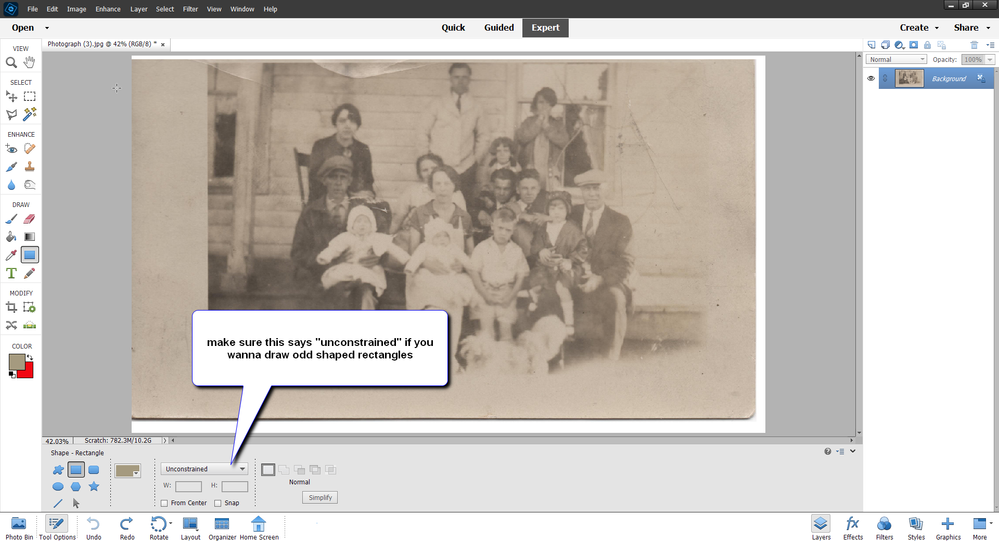

I find it so frustrating that this discussion is 9 years old and Adobe have still not provided a simple way of drawing a box!!!! Why do things have to be so non-intuitive and stupidly opaque and obscure? You should be able to choose a simple box tool and draw a box, what is so hard about that? And when I go through this process and finally manage to draw one using the select tool (yeah that's logical, use the select tool and not the rectangle tool to draw a rectangle), when I go to resize it, it only resizes proportionately. I want to resize it disproportionately, because I want to draw a number of rectangles and duplicate them to make a grid because Photoshop is so moronic that it doesn't have a draw grid function (I mean a grid that actually appears in the picture, not the grid you just see on the screen as a guide). How do I do that? Where is the thing that allows me to resize just two sides not four?
Glenn 8675309
June 19, 2022
It always helps to post screenshots of what you are having problems with.   you want help with drawing rectangles that are not filled, or do you want to make grids?  Do you want non filled rectangles?
What do you need a grid for anyway?
You can make one click grids using brushes or filling with patterns, brushes are easier to do it with--- in PSE brush size is limited to 2500- but there are ways around that.
