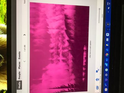

I have Elements 2022 but having trouble with my lossless compressed M size files for the Sony A7IV updated recently which I believe might be covered in the ACR raw 15.2.  They are looking pinky and distorted. I have updated different raw versions before by following the the directions about copying file and moving it to the the proper version in the common file section. Should I be able to do this again?IMG_1054.jpeg I have a newer windows 11 computer with very good current software.
Apr 22, 2023 Apr 22, 2023
@Barbara224160921ej5, yes, Elements 2022 can be updated to ACR 15.2 if you follow the instructions in the link from my earlier post.

Thanks that worked--- now I can view the different 3 sizes of lossless compressed raw files from my Sony A7IV after the latest firmware update. Looks a lot better that the pinky purple photo I started with.

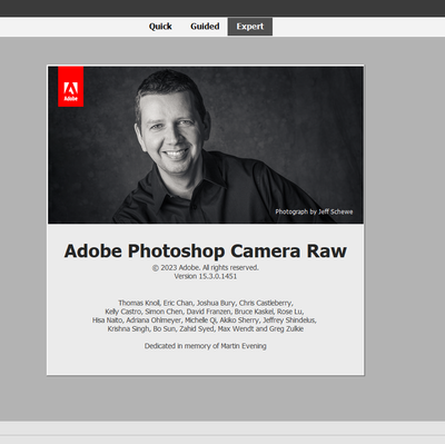

@Martin298481977qvl, as I indicated in my earlier amended post, the link provided in this thread is being redirected to a different page which does not contain the proper instructions for updating ACR in Elements.  Since you have already downloaded and installed ACR 15.3, here is what you need to do:
  • Navigate to the following folder:
    • On macOS: /Library/Application Support/Adobe/Plug-ins/CC/File Formats
    • On Windows: C:\Program Files\Common Files\Adobe\Plug-Ins\CC\File Formats
  • Copy the Camera Raw plug-in file (Camera Raw.8bi from the CC > File Formats folder that is mentioned in the above step.
    • On macOS: /Library/Application Support/Adobe/Plug-ins/Elements 21/File Formats
    • On Windows: C:\Program Files\Common Files\Adobe\Plug-Ins\Elements21\File Formats
  • Replace the existing Camera Raw plugin file with the plug-in file that you copied.
Since I know nothing about Macs, I am assuming that the plug-in file is named Camera Raw.8bi, but if you have a Mac and don't see it in the Mac location, you may have to figure out the correct file name.   If you are a Windows user, and follow the instructions, Elements will update to the latest ACR that you downloaded.
I have not yet updated my ACR to 15.3, but I do have ACR 15.2 up and running in Elements.  Please report back if you cannot get 15.3 installed and I will investigate further.

I can now confirm that Elements 2023 will update ACR to version 15.3, using the method described in my earlier post.
