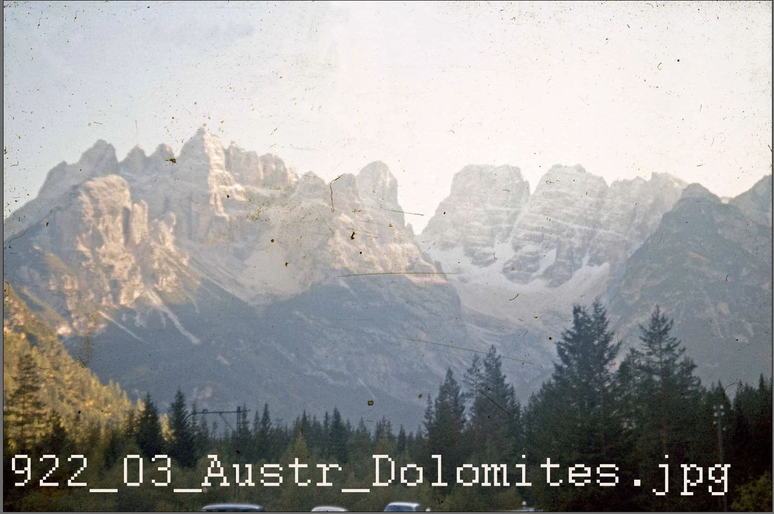

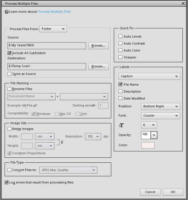

Thanks to Michel (and others) I can now bulk title all my photos, using the file names. However, there is a problem: the text is too big, even when I choose fot size 6:
Is there a way to reduce the text please?

How big are the images?
It looks like they could be slides that have been scanned at their actual size...

Thanks for getting back to me.
I'm not sure why it would matter whether the original photo was a slide or not. And I cannot now recall. But I am certain the two below are not, yet have the same problem:
I do know that I cannot get PSE12 to title scanned documents either.
I hope this may help you come up with a solution.

In the Elements Editor, could you go to Image > Resize > Image Size and note down the Pixel Dimensions (Width + Height) and the Document Size (Width + Height + Resolution). It's too rule out the possibility that the image is very small.

You don't need to change any of the info, just post the dimensions for the first image.
I've replicated the same process you used to add the filename as a caption using 6pt type on a 6.925 x 10.417" image at 240ppi and the type was tiny in comparison with the whole image. This was using PSE2021 on Windows.

As Phil has already indicated, the image size and resolution is vitally important to know.  You are complaining that a 6 point font is too big for your original photo.  A font point for purposes of digital files is 1/72 inches.  So a 6 point font has an absolute size of 1/12 inch high.
In the following screenshot, you will see a photo with pixel dimensions of 4000 x 3000 pixels.  A pixel has no fixed size.  The print size depends on the resolution of the image measured in ppi or pixels per inch.  Here, on the left, the resolution out of the camera is 72 ppi.  If I were to print the photo at this resolution, it would be over 40 inches wide.  However, on the right, I have changed the resolution to 300 ppi.  Consequently, the print size would be about 10 inches wide.  (You will see that the size of the image on my computer monitor doesn't change.  Only the scale does.)
Now, going back to the font size problem, I have used the 300 ppi file to type a 6 point text.  Because of the large size of even the smaller photo sample, the font size appears miniscule in comparison to the total image.  In the following screenshot, I have typed 7 lines of 6 point font text and even with the spacing between each line, the text would take just over 1/2 inch in height.  (Note the ruler at the side of the screen which is divided in inches.)
So, to fully understand whether or not there is a problem with using small text in the Process Multiple Files dialog, please give us the information requested by Phil.
