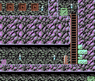

When I use the Colour Replace tool I use the dropper on part of my image to select the colour I want to replace.  All of the hundreds of areas I'm replacing have exactly the same single colour.  Attached is a small section of the overall image by way of example.
When selecting the replacement colour I click on the replacement colour swatch and type in the hexadecimal value.  But when I go back to my image and check an area where the colour has been replaced the hexadecimal value is different to that which I entered.  Why is this?

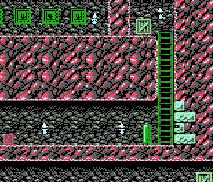

Hi Jon, and thanks for the video.  I hadn't noticed the warning about web safe colours but I'm fairly certain that isn't the issue.  If you hover your mouse over the little coloured warning box it says to click on it to change the new colour to a web safe colour.  If you do this then it changes the replacement colour to hex #66cccc.  Then click OK to apply this to the image.  Now using the picker tool to verify the colour in one of the regions changed shows that it has in fact applied a colour with hex #85b4b4.  So, again the program has replaced with a colour that was not that selected in the Color Replace tool despite the requested replacement now being a web safe colour.  This is now driving me mad.....
Don't worry about the blotchiness, the image I'm actually working with has hard edges and only blocks of solid colours.  Here's a link to the psd file that I'm working on: https://1drv.ms/u/s!AkusSFHlKO4LnlIchLw9cIbd1DLU?e=5GgJj0

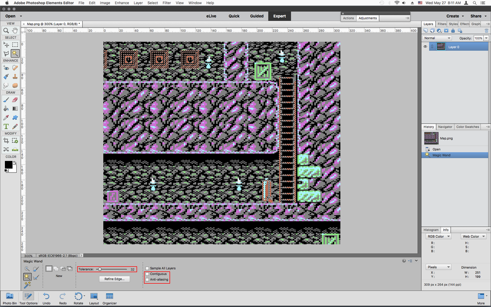

Replace Color is not a precise tool for specifying exact colors, but is perfectly good if just want to replace
a color with another shade and don't need exact colors.
One way to approach your task would be to use the Magic Wand Tool and then a Color Fill Adjustment
layer for each color your replacing.
For example, replacing the HSB values of 14,57,73 with HSB values of 357,67,55 could be done in the
following manner:
1. Select the Magic Wand Tool and uncheck Anti Aliasing and Contiguous using the default Tolerance of 32
2. Click on one of the Orange Squares and that should select that color in the whole image
3. Go to Layer>New Fill Layer>Solid Color and set your HSB values of 357,67,55
Repeat for each groups of objects of the same color
Full map
