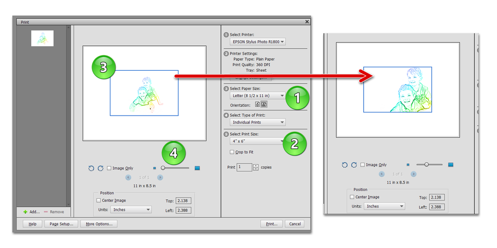

I'm not exactly sure what your problem is.  You have an original image that is 1006x716 pixels.  You want to print an image that is 4x6 inches.  But you don't have any 4x6 paper, so you want to use 8x11 paper.  Do I have that right?
Your original image does not have a 4x6 aspect ratio.  So the only way you can print the full image without cropping or distorting it, is to reduce its size so that it will end up with some (uneven) white borders.  In other words, you cannot fit a round peg into a square hole.
Try the following:
  • Do nothing with the original image.  When you print, use the following settings.  (Your printer may vary.) (1) Set the paper size to 11x8.  (2)  Set the print size to 6x4.  You will then have a preview of a 6x4 image placed on the 11x8 paper.  (3) You can then click and drag the image within the bounding box to adjust what part of the image will print.  (4)  You can also use the zoom control to adjust what part of the image will print.
If this is not what you want, please post the image you want to print and we can tell you how to resize it to print at 4x6.  But this will require either some distortion, some cropping or some borders at the sides.
