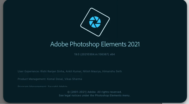

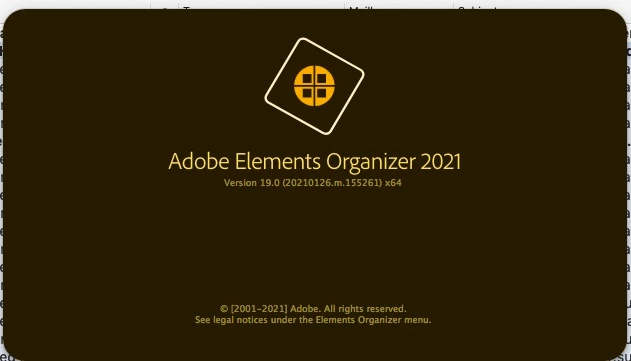

When will I be able to process raw files from Nikon Z6 ii/Z7 ii withoiut taking additional steps?
Correct answer Phil Pickering
Mac OS 10.14.6 Elements v 19.0
About displays attached.
The plugin installer did nothing.
I am running the trial version..
Hi Karl,
Have you definitely completed steps 7-10 of the workaround instructions? You can't just run the installer and not move the required file to the folder where Elements can see it.
This solution definitely works on Windows 10 but you're the first Mac user I know to try it.
And it shouldn't matter that you're running Elements in trial mode.

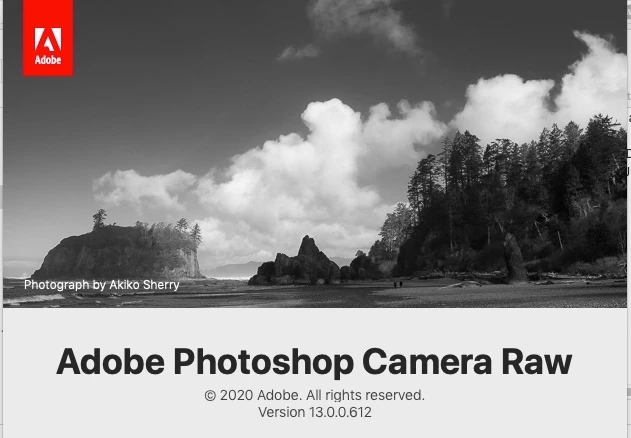

Those cameras were first supported by Camera Raw 13.1.
Try this Adobe workaround to install the latest version of Camera Raw in your version of Elements and see if you can open Raw files from those cameras without first converting to DNG.
https://helpx.adobe.com/au/photoshop-elements/kb/camera-raw-update-not-available.html
June 16, 2021
John, neither ACR 13.1, 13.2, 13.3 seem to update Adobe Elements..
