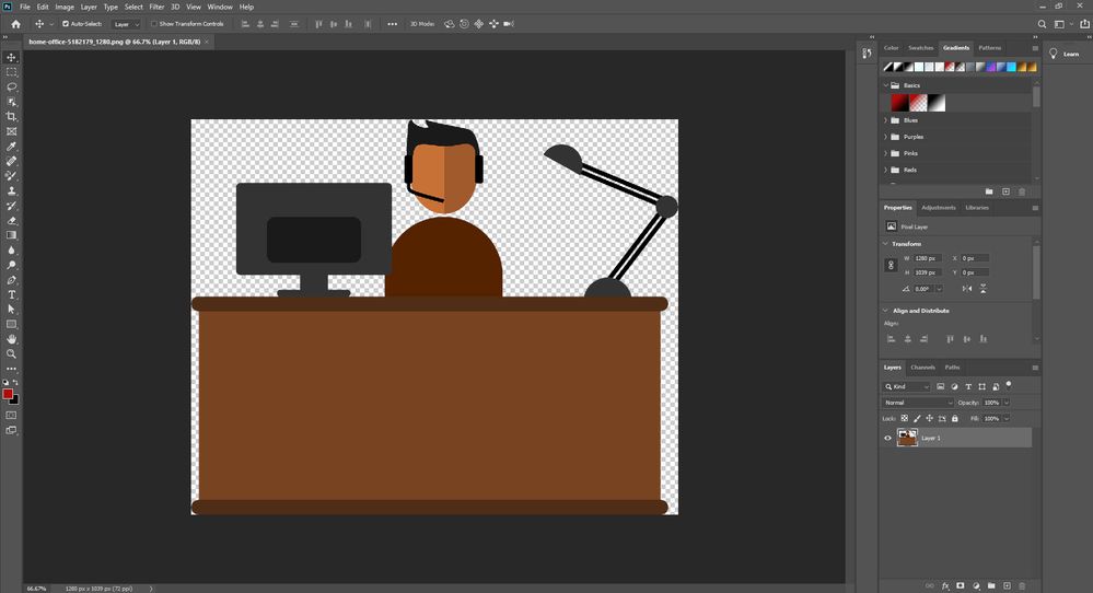

Hi Friends,
I have a vector image (png) that has a transparent background. I want to remove a part of that image. How do I do that and preserve transparency?
Thanks in advance!

»I have a vector image (png)«
That’s oxymoronic, png is not a vector format.
Please post the image in question or at least a screenshot with the pertinent Panels (Toolbar, Layers, Channels, Options Bar, …) visible.
Try applying a Layer Mask to the Layer.

Forgive my ignorance on the vectors.
I want to remove the head and body but keep the rest.2020-06-13_14-45-39.jpg
Jun 13, 2020 Jun 13, 2020
• Layer > Layer Mask > Reveal All
• paint out or use the Selection Tool to hide the parts you want to remove by making them black in the Layer Mask

Thanks for responding. Ok I'm good with Layer > Layer Mask > Reveal All
But from there I need help. I make the selection but not sure I understanding turning the selection to black?
Thanks
Jun 14, 2020 Jun 14, 2020
Please post a screenshot with the pertinent Panels visible.
If the Layer Mask is selected then setting the foreground color to black (D and X) and hitting alt-delete should fill the selection with black.
