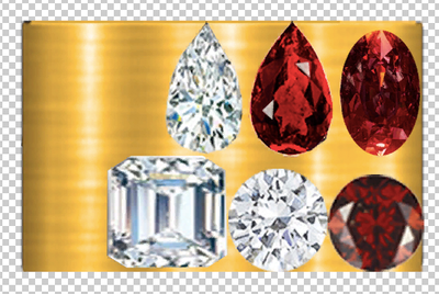

Hello all! I was wondering how to recolor the red diamonds while keeping the diamonds texture so they don't lose the "sparkle" effect. I have tried adding a second layer to the original layer, choosing a bright yellow color, and painting over the diamonds but it turns out verryyy dark. Layer 2 is at 100% oppacity. Is there anyway to make it lighter? Below is a photo of the original layer 1, and then the color I get. Thanks in advance! What the original image looks likeWhat the original image looks likeAfter adding the yellowAfter adding the yellow

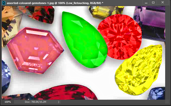

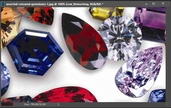

Try a Hue/Sat adjustment layer and a curve
Dave

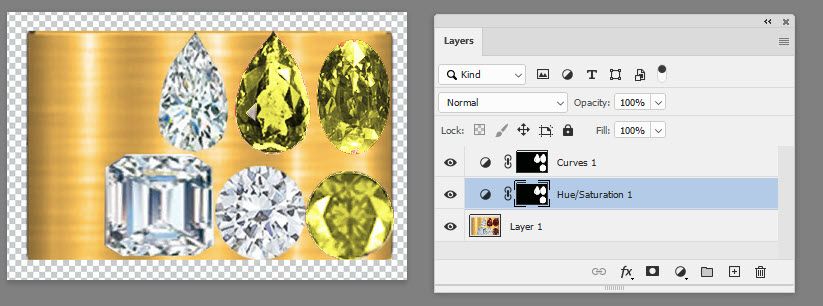

I didn't change the whole image - I made a selection before adding the adjustment layers so they each have a mask
Dave

Sorry your images did not show at first. That worked for me. Thank you so much!
