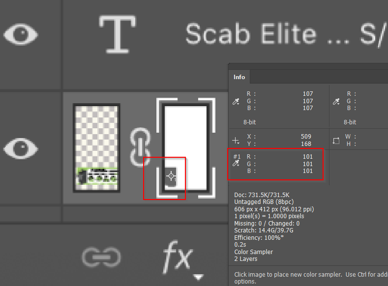

I am having the same issue I dont know what to do aftwr trying almost everythng in here, sofrustrating. 
Look at this

I double-clicked the mask, Mask Properties popped up, and I set Shift Edge to -100%. This is what fixed the issue for me. Try experimenting with the Mask Properties.
