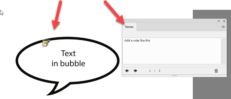

Have you tried using custom shapes. Remember you can create a custom shape using the pen tool then save it (Edit - Define Custom Shape) for re-use in the same or other documents.
Dave
Dave

Just another thought. Depending on how you are using the text bubbles. If the info is to be part of the final image then my last reply applies, however if you just want annotations only for yourself - you can use the note tool. When you click on a note icon -the note can be read in the note panel.
Dave
