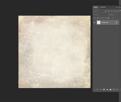

Is it possible to save a single layer that has been blended to the layer below? I have 2 textures that I blended and I want to keep the distressed look of the top layer to place onto other textures and delete the base layer. I hope this makes sense.

Could you please post a screenshot with the pertinent Panels (Toolbar, Layers, Channels, Options Bar, …) visible?
Once you have merged two Layers (and the merging can’t be undone via history, previous version documents, …) it is possible to accurately separate their content only in some special cases.
If the two Layers are still separate duplicating the top Layer to another image should not be a problem.

I have attached 2 screenshots. The second one shows the gold layer able to move and if it's possible I would like to save it with its 'merged look' but be able to replace the stone with anything else.1.jpg2.jpg
Sep 14, 2020 Sep 14, 2020
I suspect I don’t quite understand what the problem is.
What do you mean by »merged look«?
What happens if you insert some other image and how does it differ from what you want to happen?

Sorry I should have said 'blended look'. In the 2nd photo you can see the stone through the gold. Originally the gold was solid. After I blended it with the stone layer using 'Darker Color' it looks like part of the gold has been distressed or rubbed away. I would like to save this distressed gold layer as a png to place on top of other textures.
»Darker« works both ways, so you could Clipping Mask the stone-Layer to the gold-Layer, set it to »Darker« and use the gold-Layer’s Blend If-settings to create transparency.
But quite frankly it is still not completely clear to me what result you expect exactly.

Ultimately I would like to have a png of the distressed gold on a transparent layer. I can only achieve this look when the stone is involved. I have attached a photo of a piece of paper in pic 3 that i would like to place the transparent gold png onto. If I place solid gold on the paper and blend the 2 together it only removes small parts of the gold.
Pic 1: Solid gold on stone before blending
2: Gold and stone blended
3. Plain paper
4. Paper and gold blended
I would like to have the gold on the paper look the same as it does on the stone. It is not distressed enough.1.jpg2.jpg3.jpg4.jpg
If I could have it saved as a transparent png in the stone blending process I could just take the transparent gold and place it on the paper with no blending.
Have you tried using the Blend If-settings?

You are a genius!! That works perfectly. I've never used that before so It's opened up a whole new world of possibilities.
