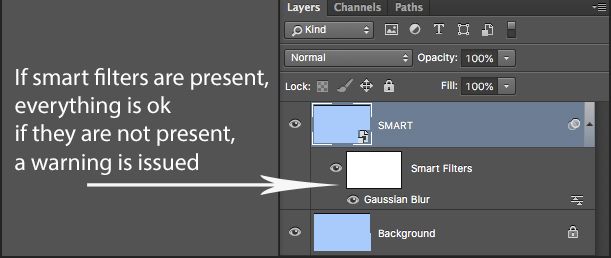

I would like to find a way to see if I am
present in an advanced smart filter object
If smart filters are present, everything is ok
if they are not present, a warning is issued.

Nov 23, 2019 5:57 PM UTC
Mr. r-bin
I hope you can help me
My problem is this:
I have many psd files with advanced object layers
some of these have no smart filter inside
So if advanced object has internal smart filter '
Go on
if it has no smart filter it deletes the advanced object level.
