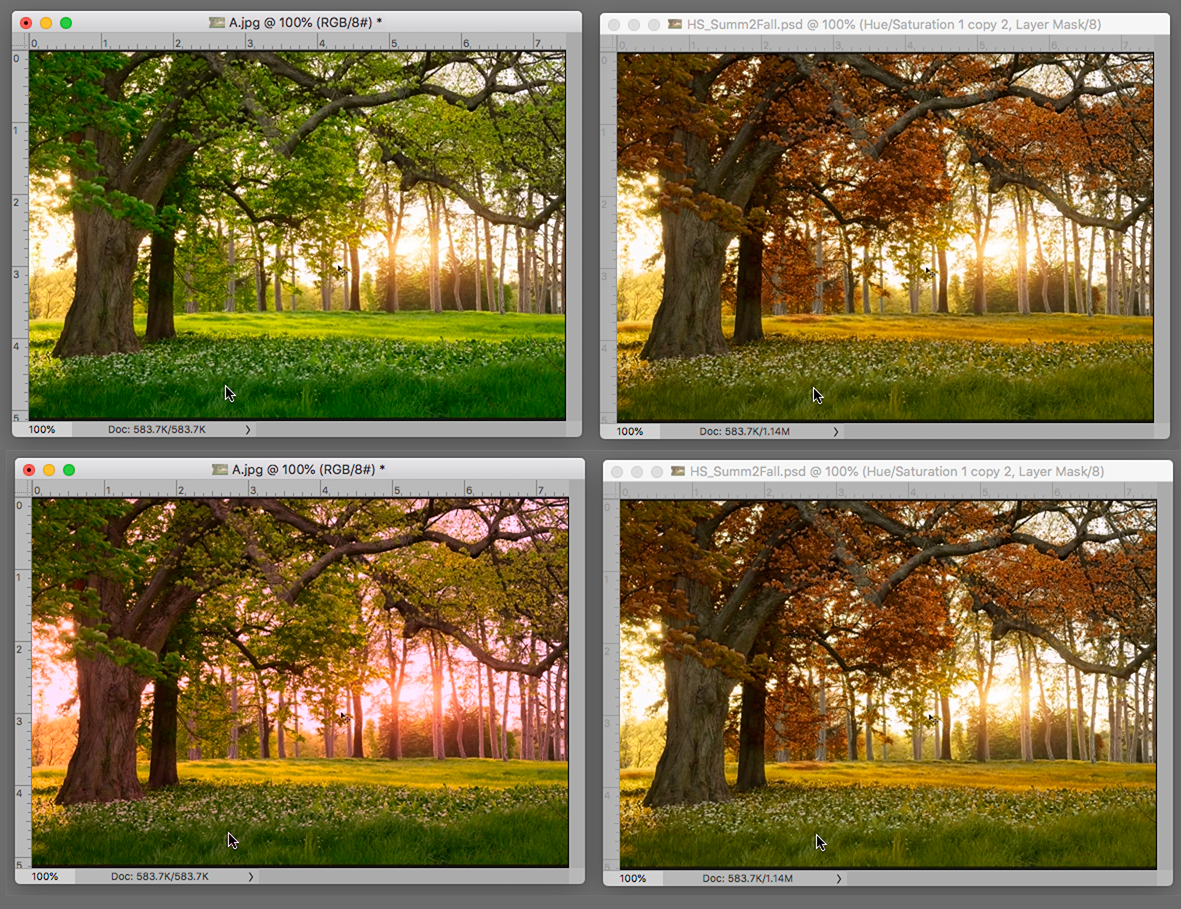

If you have ever had consistent success with Match Color, I salute you.
For example, I duplicated an image and changed Spring to Fall.
Fig 1 is the original image
Fig 2 is the reference image. The goal was to make Fig 1 closely match Fig 2.
Fig 3 is the Match Color result
Fig 4 is a duplicate of Fig 2, the reference image
I also made a selection of the top part of the reference image and placed it on a separate layer, to reduce color variety.
Did the same with the original image.
The result was far worse.
This boils down to a recommendation: before you rely on Match Color, try a few tests similar to this and draw your own conclusion. It is worth your time.
