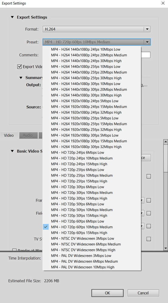

Hi all, relatively new to elements 2021. I am recording video at 1440p/120fps using streamlabs (video game). Videos are saved at 1440p and look amazing with windows move player. I open a new project in elements, select 1440/60fps using the "custom" feature, open the timeline and then import my 1440p video. When I am done editing, I go to export, but their are no slections for 1440 and the custom box says "I must have a custom preset selected". This leaves me with the best possble option to export in, 1080 30fps.

Maybe I mistyped what I was trying to say. I created a 2560x1440p 120 fps video. I then imported said video into my project, using a 2560x1440p 60fps preset (have also tried some custom presets). When creating a new project, I then import the video and do my work. When I am finished and I go to export, the best options it gives me (are there are quite a few) is 1920x1080p 30 fps. There is no option to export to 2560x1440p 60 fps resolution. Maybe I am missing something.

There is no preset for 2560x1440p 60 fps so please post screenshot project settings.
As for export settings you can go into custom > advanced settings and change resolution and framerate.

Forgive me, I made a custom 1440 preset as well as downloaded some premade ones, neither are working.
I figured out that my videos were not saving as 1440, but as 1080. I have now fixed that and my videos are now in fact 2560x1440 resolution. I still have no option to export said video as 1440p..
Nothing shows in my "preset" box and the custom settings do not list 2560x1440, Here are some screen shots.

In the advanced settings you dont choose a preset but rather set the parameters manually.
Then save as a preset.
