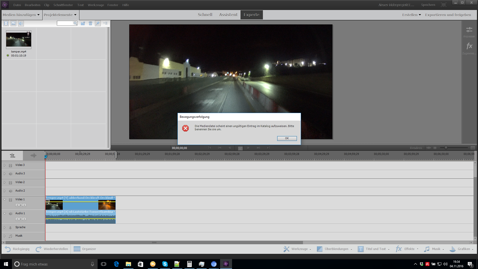

When trying to user the motion tracking tool I started getting the error "The mediafile seems to have an invalid entry in the catalog. Please rename it." This error started coming up after the update from 14.0 to 14.1 and it comes regardless what video file I use. In the attached screenshot I even used a video files which I rendered just upfront with Premier Elements for testing. Also renaming the file or just the clip doesn't work neighter, nor does it work if I start it in an all new project.
I run it on a Windows 10 64 bit machine and it used to work fine prevsiously. Hope anyone has any idea what is happening there. Ah just to mention all other tools like "Freeze the frame" or "Smart Trim" aso working fine.

Da war der Fehler. Danke. 🙂 Es haben zwar weder die Reparatur noch die Optimierung des Katalogs geholfen, aber einen neuen Katalog erstellen und den alten löschen hat funktioniert.
