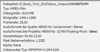

Footage was created on a Sony a6000 and GoPro Hero 8 Black:

If you delete all of the GoPro footage from one of your project copies and fill in the blank spots on your timeline, does it output? (Once you've removed all the GoPro video, check under the Edit menu and see that 1440x1080 25 fps is listed on the General page of Project Settings.)
The program should be able to do it,  but it's worth checking to see if the mix of those two very different video formats is overwhelming the program.

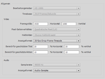

As I've said, much depends on your Project Settings, which you'll find under the program's Edit menu. I'm not sure what your Project Settings were when the project was giving your problems, but apparently they are now more compatible. Though that's hard to say since I don't know what your Project Settings are now either.

There is noch much i can change here.
LEGEND ,
Jun 22, 2022 Jun 22, 2022
This isn't a screen you can change, Christoph. But it does tell us our project's settings.
Right now your project is set up as 1920x1080 at 30 fps -- which doesn't match either of your source videos. This will give you very ineffecient playback and might be the cause of your problems.
Usually the program will automatically match the specifications of the first clip you add to your timeline. What is the first clip on your timeline?

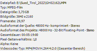

That's the first clip:

As an experiment, try starting a new project and then add one of your 3840x2160 clips to the beginning of your timeline. Then check your Project Settings. I'm interested to hear if the program is matching its settings to this video.
If not, it could be because this video has Quicktime MP4 specifications. But that shouldn't matter.

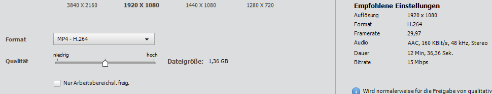

I might have to correct me...
I was trying to render it at 1920x1080, but the project setting is 4k. Right now rendering it at 4k seems to work... We will see
