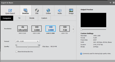

I have mostly been trying to use the Quick Export in this menu here:
I have tried exporting in several different settings, such as the 1080p and 720p settings.

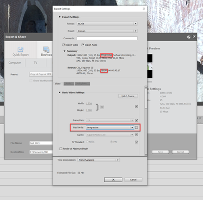

I have also tried playing with the advanced menu for exporting. When I go to the advanced menu I see this, I'm not sure if it helps:

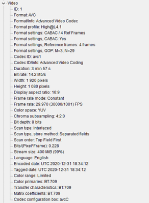

Here is a screenshot of the tree view of the exported video from MediaInfo:

You've got plenty of power and your video should be pretty easy to edit. But I'm assuming the MediaInfo report is for your original video, not your output.

Use the Advanced Settings
You are not compeled to use the standard presets.

Hi Ann,
I tried outputting using the progressive setting as per your attached image, but the output was actually much worse in terms of jitters. In addition to this, the video itself looked quite blurry. Do you know why this might be?

As I said, the MediaInfo report for the output video is of no value in figuring out this issue.
We'll need to see the MediaInfo report from your original source video.

Jan 06, 2021 Jan 06, 2021
You have a couple of issues.
Its not HD but UHD which is 3840x2160 and not 1920x1080.
Its not H.264 but H.265 (HVEC)
Its not interlaced as in upper field but Progerssive.
And last it has variable framerate which usually will give issues.
Needs to be converted to constant framerate with Handbrake before import.
Start new project, leave it empty and drag the clip into the timeline. That will give matching settings.
