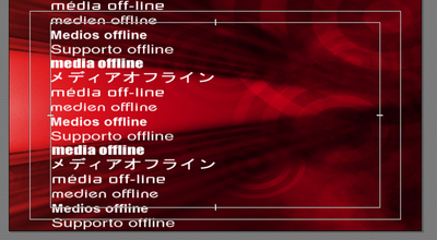

When I open a .prel file my only choices to select are MPEG or XMP files.  I select skip all and and get this :
The music is there and the transitions that I put in are all there, just no video or sound.
When I look at the project assets it shows .MTS for the name and under media type is offline.  However there are rendered videos that are .mpeg under media type as well but when I open them they play without sound. Example below.

Sep 14, 2020 Sep 14, 2020
"Thoughts?"
When you start a new project all the source files and the project files themselves are linked with exact locations.  They can't be moved, deleted or altered.  The multilanguage "offline" screen is the indicator that you've moved, renamed or deleted the source files.   An MTS file is typically from a camera advertised to shoot "AVCHD" and probably a Sony or Panasonic.  Where are those files?  In the Project Assets box you can right click on the file icon and find a choice to locate those files.
I'm guessing, but did you build your project with the video files still on the card or camera?
It may be easier to start over with all the files in the same place and not moving them until the project is complete.
