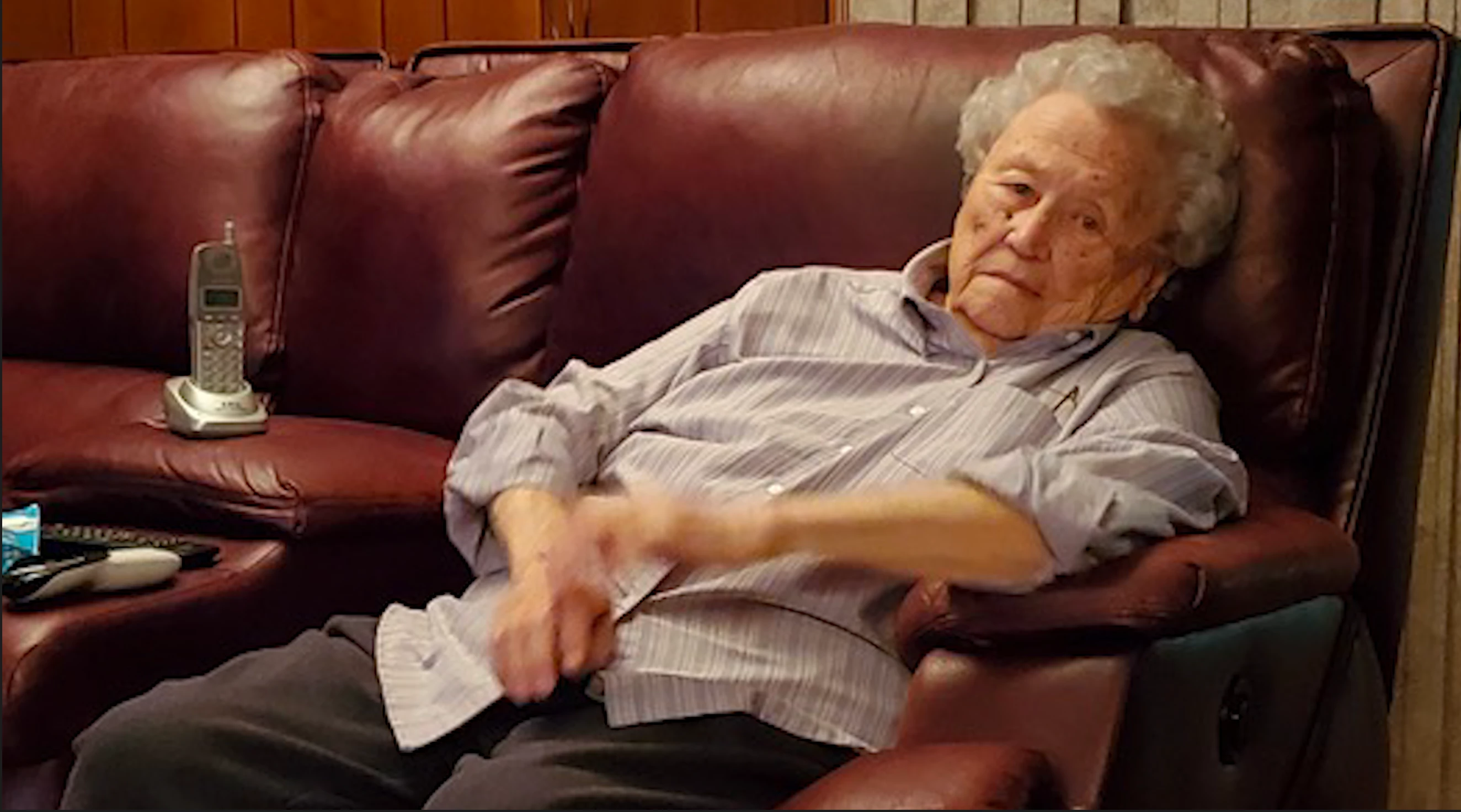

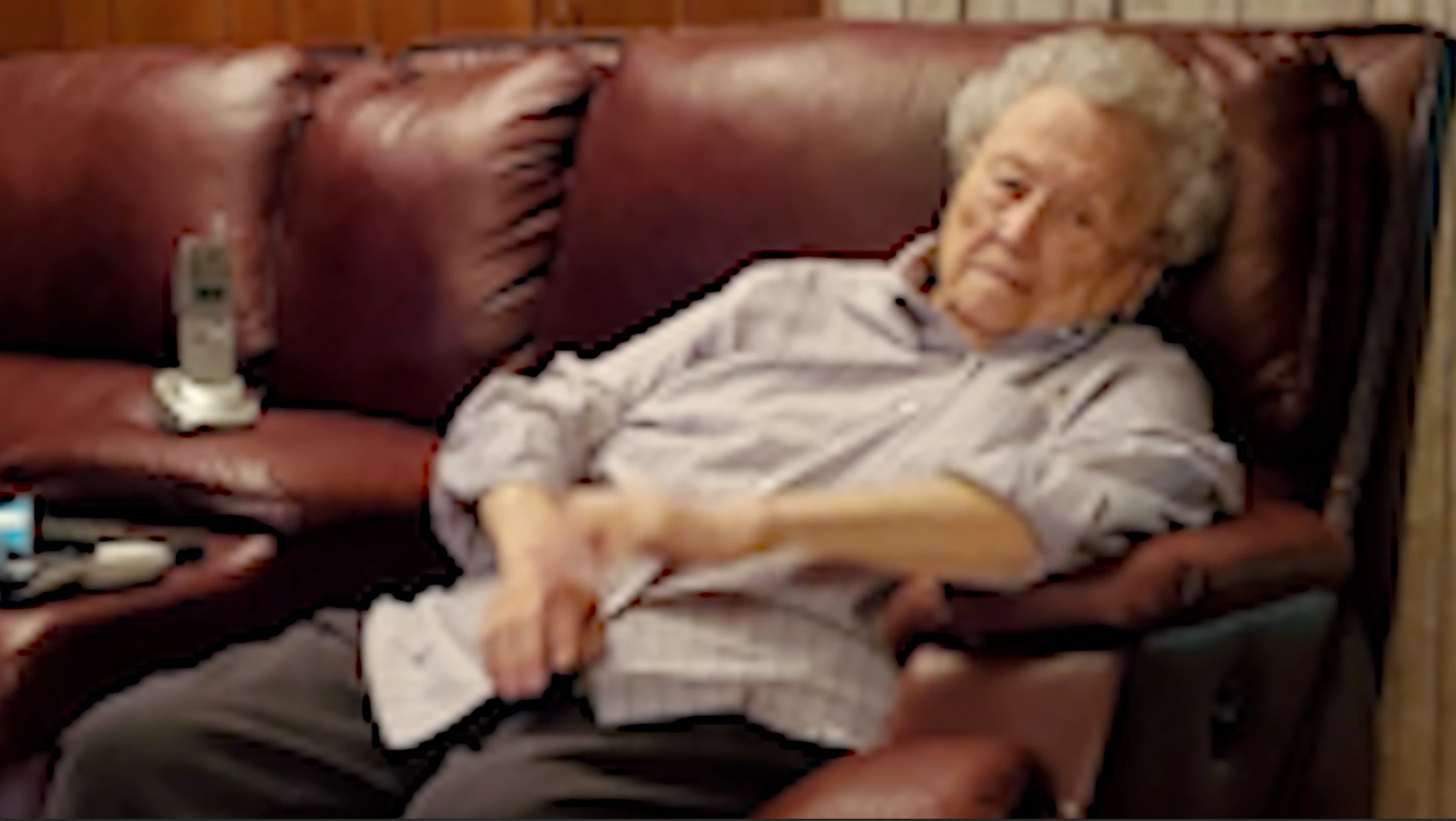

And the issue is that there is a significant degradation in the quality of still images that I am using in the timeline, when comparing what I see in the Program window (or in fullscreen mode) during normal playback vs what the image looks like in the final video clip upon export.  Attached are the expected, better image (a screenshot of the Prorgam window in Premiere), and a frame of the exported, degraded image (from my h264 output).

1) Strangely, when I toggle between 1080 or 720p on this current session, it's no longer looking degraded in the Preview window in the Export tab, though it DID look degraded at that step when i submitted my initial post.  HOWEVER, it is still exporting with the degraded quality, regardless of it looking as expected in the Preview window.  And for the record, it won't even allow me to do a UHD output with the presets I was using (h.264). When i try to select UHD export it says "Invalid framesize/framerate for this level.  Please lower the video bounds or frame rate, or increase the Profile and Level and try again")
2) yes, duplicating the sequence and then re-sizing to 1080p does produce an output that looks as expected in regards to the still (so much better than exporting 1080p from the UHD sequence), however this is a small portion of a documentary that's already got hundreds of clips in the timeline, so this isn't practical as a regular output solution for me.  but...
3) The technique of nesting the UHD sequence in a 1080p sequence before exporting a 1080p clip does appear to solve the issue as well.  This also worked for a 720p output (with matching sequence and export settings), which is probably what I'll do to save on my storage space for posting cuts.  So that's a simple, non time-cosuming workaround for me for the moment (and really should be fine for a while).  Thank you!

Can you do me a favor and go to the export settings using the UHD sequence and then toggle the export from UHD to 1920x1080? You should see the immediate degradation on the still when you do this. We will look into why you are unable to export an HD format from the UHD sequence without any degradation. For now you can do one of two work arounds. You can make a copy of your timeline and change the sequence settings to 1920x1080 . You will need to resizing on your shots to match and then you can export HD to HD without degrading the stills. Or you can Nest your entire UHD sequence and then make a duplicate of that sequence. Change the settings to 1920x1080 and then resize the nested clip to 50% and all the sizing will match what you had in the UHD sequence. If you export this new nested, 50% , 1920x1080 sequence you will also get no degradation to the stills.
