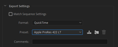

Don´t use ProRes 422 HQ, use ProRes 422 LT for YT uploads. The file will be large, but significally smaller than HQ but not as small as H.264 or H.265.
For bitrate settings that suits your footage you have to try different settings. There is no easy way to recommend best settings for certain videos, try, try, and try again is the way to go.
When testing, don´t export the whole timeline. Export the part that has issues when uploaded to YT. It´s faster to find the right setting when exporting let´s say two minutes rather than one hour at a time.

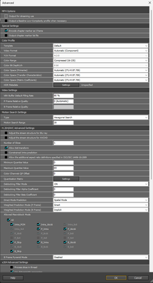

One more thing that can create higher quality H.264 files is to change the GOP settings. For the built in H.264 encoder, look for the Advanced Settings in the video tab in the Export Settings dialog and check Key Frame Distance and set it to 60. For the TMPGEnc encoder, look at the same place but under GOP Structure Settings and set the Normal Number of Frames in GOP to 60
You export to 60 fps hence the setting 60.
Since you have the TMPGEnc plug-in installed i would use that to either export directly from the timeline or export a ProRes file and bring that into Adobe Media Encoder and encode it there. The latter is faster.

I tried to find a key frame distance slider for TMPGEnc, but I don't see one.  I'll try it for H264 though.
By @Tripecac2
To see the setting, use the Standard (High-bitrate) Preset and adjust the individual parameters such as bitrate and GOP Structure Settings.
Try some renders were you raise the bitrate as well to see what, if any, difference it makes.

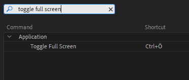

How does the actual source footage from the camera look on the timeline were you see the blotchiness in the exported video? Does it look crisp clean or does it suffer from some blotchiness as well? Playback the source video in Premiere Pro at those places and use the keyboar shortcut for Toggle Full Screen to se the video full screen. Use the ESC key on the keyboard to exit full screen mode.
This shortcut is great track down issues like this.
To find out the correct shortcut for your system, press Ctrl+Alt+K to launch the Keyboard Shortcuts dialog and type in toggle full screen.

Regarding tweaking settings for the TMPGEnc encoder you can enter more settings by clicking the TOP-LEVEL VIDEO PARAM GROUP > More > Advanced in the Export tab if you use CC2023 or just click the Advanced button in AME or previous versions of Premiere Pro.
This opens a big Rabbit Hole of settings, so one must do some serious reading to know what to do and why/why not. All those settings are way over my head so unfortunately i cannot provide you with any help there.
If you locate one of the sections that looks bad on your timeline and export those 10-20 seconds as QuickTime > Apple ProRes LT and then upload that file directly to YouTube, how does it look when uploaded? And how does it look on the timeline before you export it?
