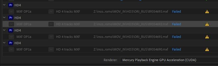

We're receiving various errors in random episodes, some are about PProHeadless.exe, some are different.
After processing a file queue, the error tends to appear after switching to the next file. (see the picture attached) and the computer freezed after nightly run.
The errors occurs with and without 3rd party plugin used(Jumnger audio)
So far, all attempts to solve the issue have failed.
Timeframe what's done so far:
1. All drivers updated
2. Adobe updated from 21 to 22
3. Computer HW diagnostic
4. Computer reinstall
5. Adobe reinstall
6. Computer HD diagnostic and maintenance in authorized service
7. Adobe support tried to fix this w/o even looking in log files.
Obviously, after each above-mentioned step, the issue re-occurred.
Any suggestion on how to fix this will be appreciated.

I'm experiencing the exact same problem. Would be great to get a response from Adobe.
LEGEND ,
Jun 14, 2022 Jun 14, 2022
MXF files? Being read directly off the card? Any dynamic link to Audition or After Effects in use? Any power management in use?
New Here ,
- H.265 files from a Sony A7siii
- Files are being read from an internal SSD
- No dynamic link
- No power managment in use
Apart from the files only rendering 4 at a time before it freezes, I can't queue more than 10 or so sequences to export. Once Media Encoder has frozen I need to exit and start it up again and reset the status op the last clip. It then runs again for 4 or so clips before it freezes again.
New Here ,
For me answers:
MXF files
Files read/write directly from m.2ssd and from/to network.(both scenarios fails)
Same errors with and without links and effects. Usually, Premiere with Encoder is being used. VST audio level plugin.
Power management - High Performance (with default windows 10 settings)
LEGEND ,
Jun 15, 2022 Jun 15, 2022
That would explain why prproheadless is involved: the trip to media encoder. The VST plugin, is it new? Old?
Try ingesting some MXF clips and transcode them to ProRes on ingest (found in project settings). If that is the only change, do you still get the errors?
The transcoding is a possible workaround; lots of folks seem to be having serious issues with MXF files.
Sidebar: there aren't (m)any programmers here in this forum, so a full crash report isn't all that useful. It makes it difficult to navigate the thread and is generally off-putting to other readers, which reduces your chances of getting help. All your other info has been really good, though.
