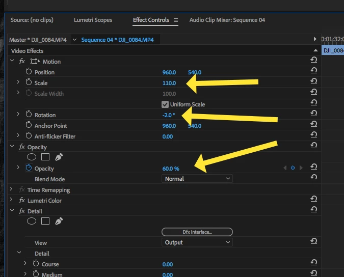

    Place one clip above another on the timeline (clip one on V1, clip 2 on V2). Click on the clip on the higher track to select it.
    Go to the Effects Control panel and lower the opacity of the clip on V2 until you see it superimposed over the clip below it. Adjust the Rotation, Scale and Position until the two horizons line up and the upper clip still fills frame.
    Once that is done, restore the opacity to 100% and move the clip that was on V2 to where you want it on the timeline.
    MtD

    Instead of lowering the opacity of the layers and even better way is to change them to Difference blending mode. This way it will highlight the differences between layers. Always a great technique to use when you want to line up two layers so their positions match.

    I use a cross dissolve, adjust an then delete.
    MtD
