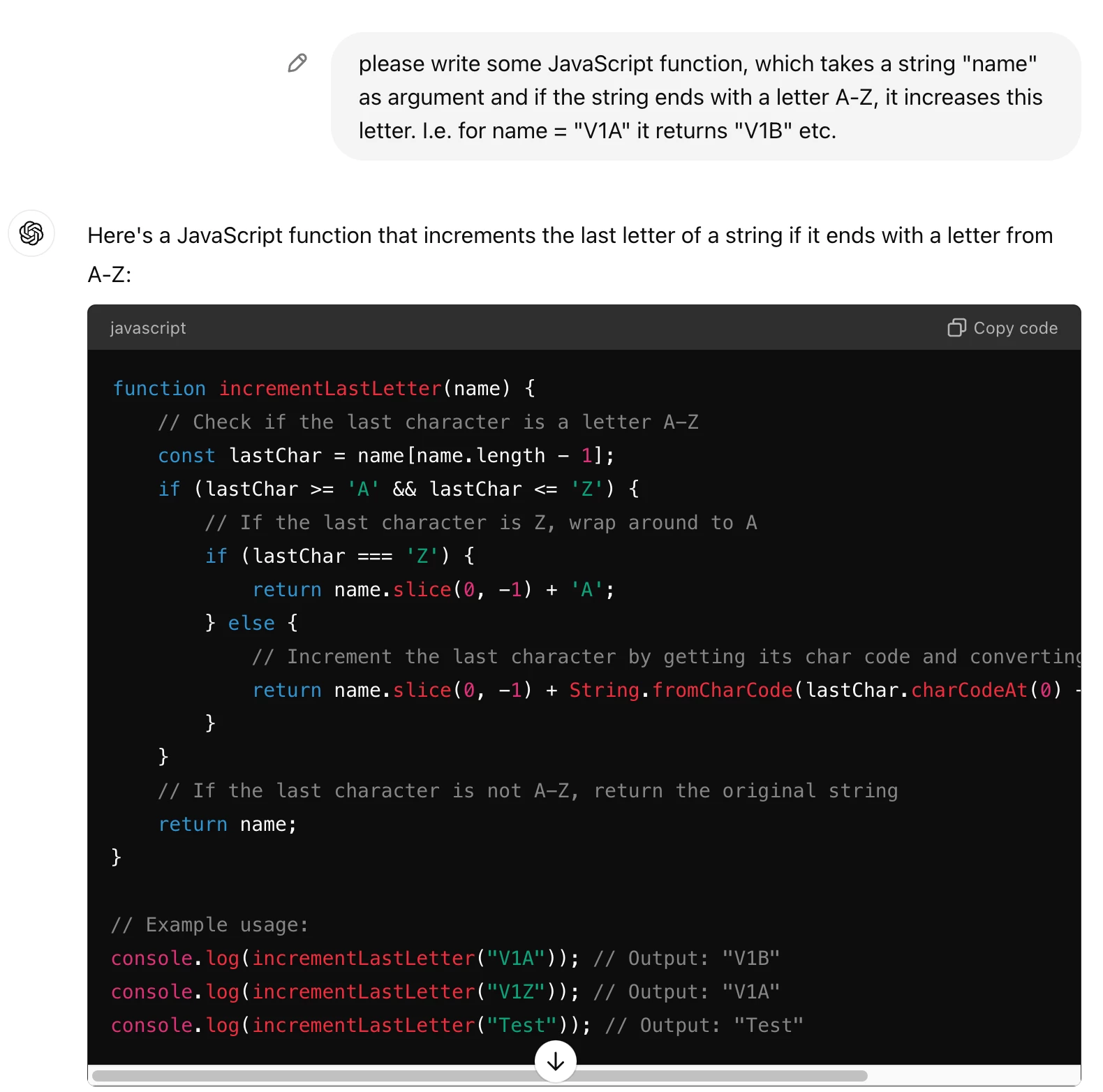

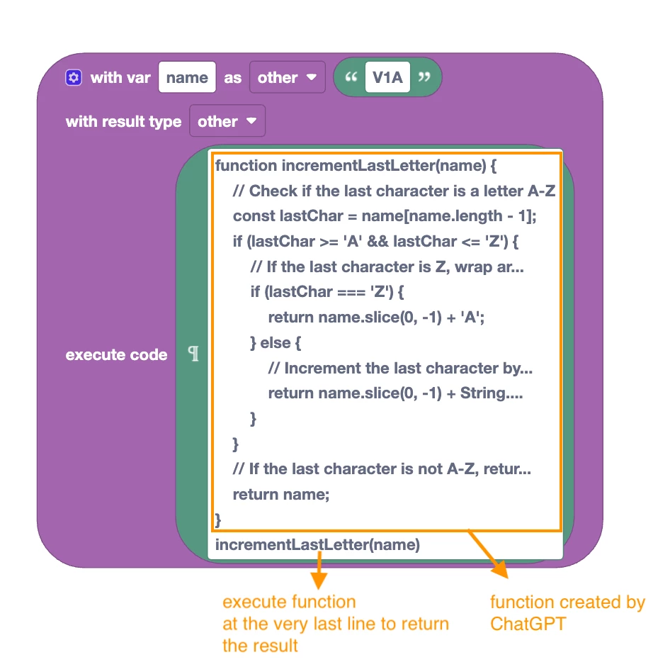

Now every sequence ends in a letter: V1A, V1B.
Any way to make the exact same script but the last letter in the sequence goes up alphabetically? Numbers don't change.
Thank you so much for your time and all the work you put into answering our questions. Understood if you don't have time to do this. You're very generous with your talents.
Mathias Moehl
Mathias MoehlCommunity ExpertCorrect answer
August 29, 2024
I just asked ChatGPT for a solution and then wrapped it into a Execute Code Block:
Block code is also attached.
I think the combination ChatGPT + Execute Code block is very powerful in all cases where you just want to do manipulation of strings, numbers, searching for certain patterns in strings etc.
