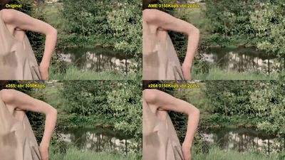

Just wanted to clarify for OP, my suggestion about encoding in H.264 apply only if 'new platform' allows streaming of original files. But if there is unavoidable transcoding on the way to end consumer, you really should deliver H.265 in this case, as at such low bitrates (below 0.1 Bits/(Pixel*Frame) it's way better at preserving details
Copy link to clipboard
Copied
a frame sample to show a difference, likely more complex than yours, but still useful imo
Adobe Media Encoder H.264 vs X264 vs X265:
Copied
Great to see the differences. And that background of trees and grass is one of the hardest to keep looking good at low bitrates! Hopefully Lisa's is indoors 🙂
