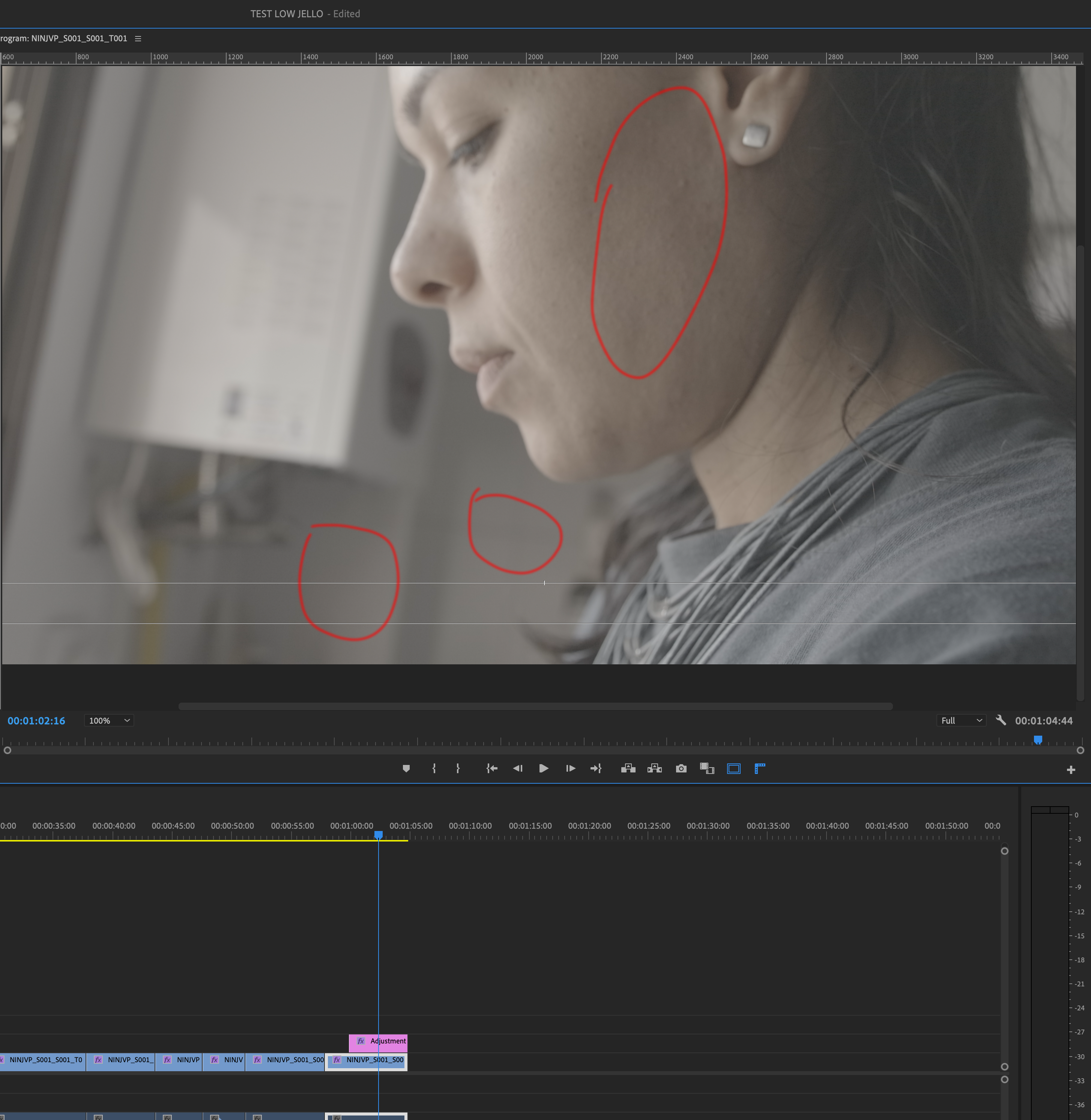

Serghios
SerghiosAuthor
April 30, 2022
does not change anything, two frames example of how the macro blocks of magenta come out in premiere while in davinci there are not. (unitled is davinci frame).
It's a bug I've encountered since purchasing the zcam in December and has remained so in all versions of premiere.
Practically unusable with this camera.
